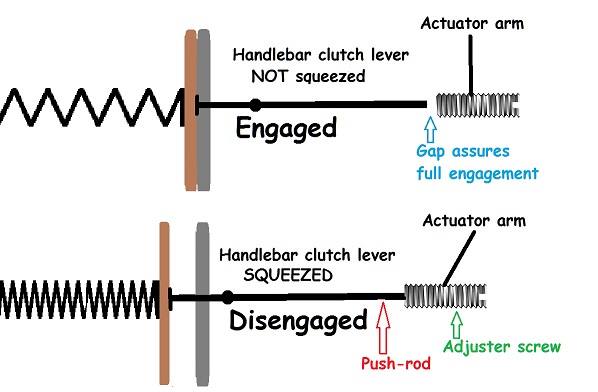

The FSM covering '77-'79 KZ1000's includes a periodic maintenance chart requiring clutch adjustment at 5000 km intervals:
Clutch plate wear also causes the clutch to go out of adjustment. This wear causes the play between the push rod and the adjusting screw to gradually diminish until the push rod touches the adjusting screw. When this play is lost, the clutch will not engage fully, causing the clutch to slip.
NOTE: Even though the proper amount of play exists at the clutch lever, clutch lever play alone cannot be used to determine whether or not the clutch requires adjustment.
While the clutch may indeed be worn out with plates needing replacement, it isn't uncommon to overlook or be unaware of the clutch pushrod adjustment feature, especially without a manual.
Where both (1) clutch cable slack adjustment is perfect, and (2) clutch pushrod adjustment is perfect, and the clutch still slips, more suspicion is cast toward the plates being worn and needing replacement. But other things can also cause slippage, even with proper adjustments and good plates, such as glazed plates or improper oil being used in the crankcase.
