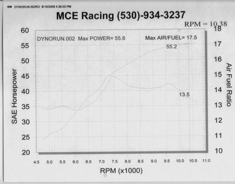

I spent the money for 2 dyno runs, and that was very interesting information, before and after the adjustments.
About 100 F at 4:30pm day 1
Day 1 HP and Air/Fuel

Day 1 and 2 Horsepower and Fuel
img.photobucket.com/albums/v97/CoreyClou...noBlackAndWhite4.jpg

The first Day 1 Dyno Runs were as everything above is described, and Kevin at MCE Racing then explained to me what he saw, and what he would like to see for the engine to run better. The air/fuel was his main concern, and at 15, that was too lean for an oil cooled engine. He wanted it to be closer to 13. Richening it up the mid section, would help it to run cooler, and make more torque. He said to run the mixture screws 5 turns out(I set them to 4.0 just for another adjustment if needed), and move the clips down 2 more notches, this will raise the needle, allowing for a richer mixture. The mixture screws not only help with idle and slight off-idle, Kevin says, but on decel, and engine breaking, it can lean or richen up the mixture as well. More turns out is more air and less fuel. People always tell me the engine is smoking on the track during, and it's the fuel mixture, causing it to be so rich on decel, so more turns out will add more air.
The last two graphs are then next morning, and after I adjusted the mixture screws, and lowered the slide needle clips(raised the needles) 2 positions. You can see that the air/fuel ratio richened up quite a bit, and the line is almost flat(see numbers on the side), and I also gained more torque, and a few ponies loss on top. He recommended I replace the 134 Main with a 133, and the loss on top would come back. I chose to leave it alone, and do this another day, when I can get the 133.
I found it very interesting, and a good learning experience to dyno my bike.
55.6 Hp @ 11,000 rpm(still not falling off) and 32.2 Torque @ 7,300 rpm initially, to 54.6 Hp @ 11,000 rpm, and 32.1 Torque @ 7,500 rpm. If anything, this tells me where I should be up or down shifting in the corners, and when I get to post the video's after they are finished downloading, you'll see and hear the engine scream out that Moriwaki Race Exhaust, singing a beautiful note.
