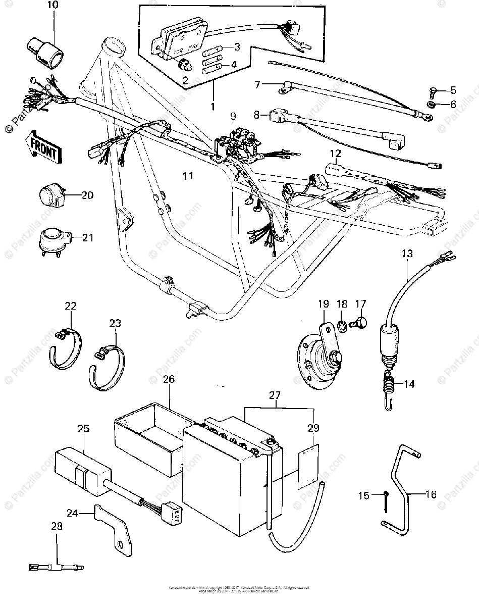

And the brake pedal went on with the usual cussing that accompanies a stiff spring. The linkage between the rear brake pedal and the stop light switch is a convoluted affair with lots of bends and twists. I'll try to compare my installation with the parts fiche for correctness. It doesn't compare well in my mind??

You have the brake light switch connecting rod upside down. There is one end that has wings pressed into it. That end goes through the boss on the pedal. Then a cotter pin holds it in place. Then the spring hook goes through the top hole

13 Sep 2023 04:56 - 13 Sep 2023 04:57You have the brake light switch connecting rod upside down. There is one end that has wings pressed into it. That end goes through the boss on the pedal. Then a cotter pin holds it in place. Then the spring hook goes through the top hole
Thanks Mikaw, I know what you mean by the pressed in wings on that squirrely brake light rod. Those wings are behind the tab on the arm of the brake pedal. You'll note that the wings are not at the switch end with a zoom.
The wee washer between the tab and cotter was my doing and doesn't seem to appear in the parts fiche.
