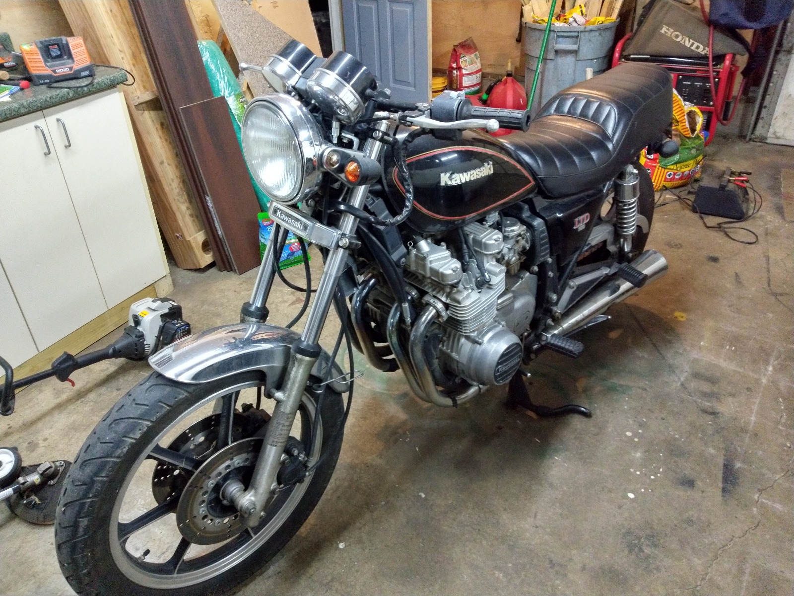

Picked up a winter project a few weeks ago. Plan to make it a cafe type bike. Nothing too crazy, fix all the cheap lights that were put on it, figure out the over flowing carb and add some new paint. Needs new tires and other general maint. Only has about 19k miles.

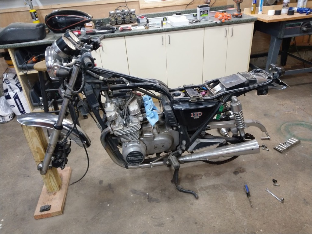

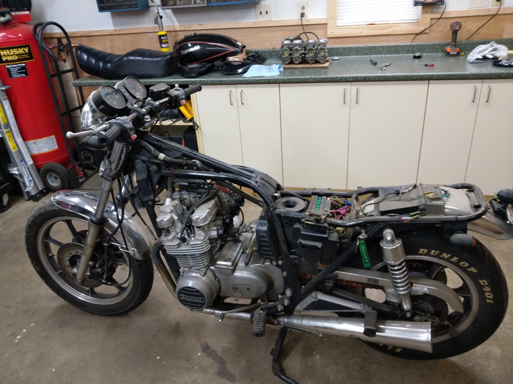

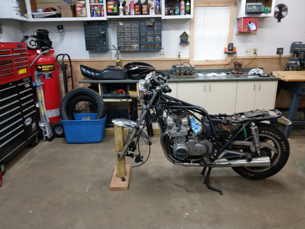

Did an awesome job of not doing much to the bike this winter, but the last few weeks have been a flurry of activity.
1) Fixed all the electrical gremlins in the lights
2) Fixed the fuel leakage issue and put kits in all the carbs
3) Changed the (original) tires and added some balance beads
4) New brake pads all around
5) Did some minor stuff like new rear lighting, grips, horn, AGM battery
Runs great, maybe someday soon after the next snowstorm I can try it out.
Have a new seat on order from Texivana
New MAC exhaust coming to replace the stock (patched) stuff
Some mirrors on the way
Plan on getting the pinstripes stripped off the tank and figure out some sort of trim/emblem to cover up where the Kawasaki logos used to be
Still need to find or make a battery hold down - was missing from the bike when I got it

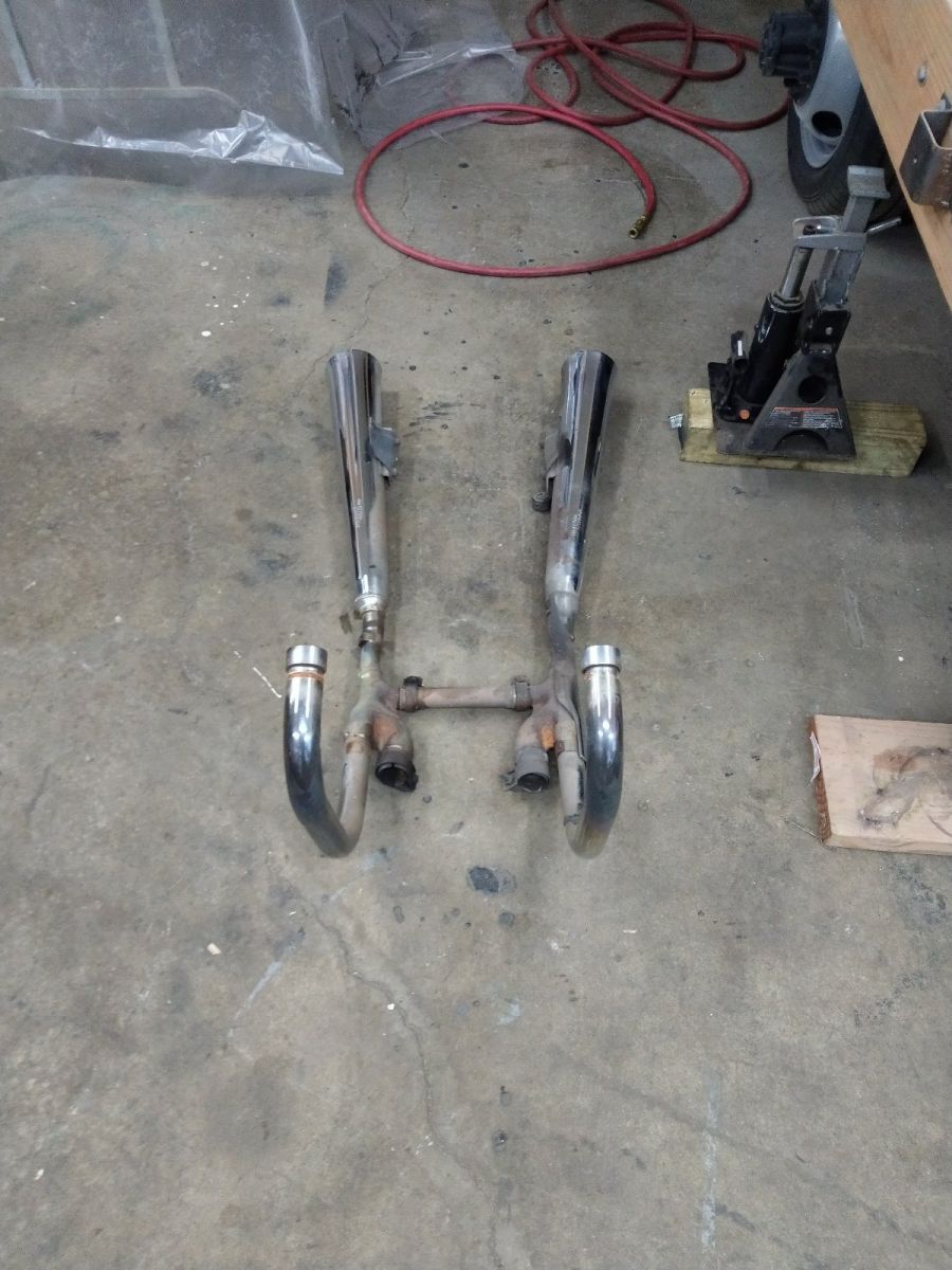

Pulled the exhaust off during lunchtime in preparation for the new stuff showing up. Still need to get the studs out, there was one broken one and I ordered a full new set of stainless that should be here in a few days. Was surprised and how easily 38 year old exhaust came off, mostly in good shape. Looks like there was a patch with some exhaust goo on one of the pipes at some point.

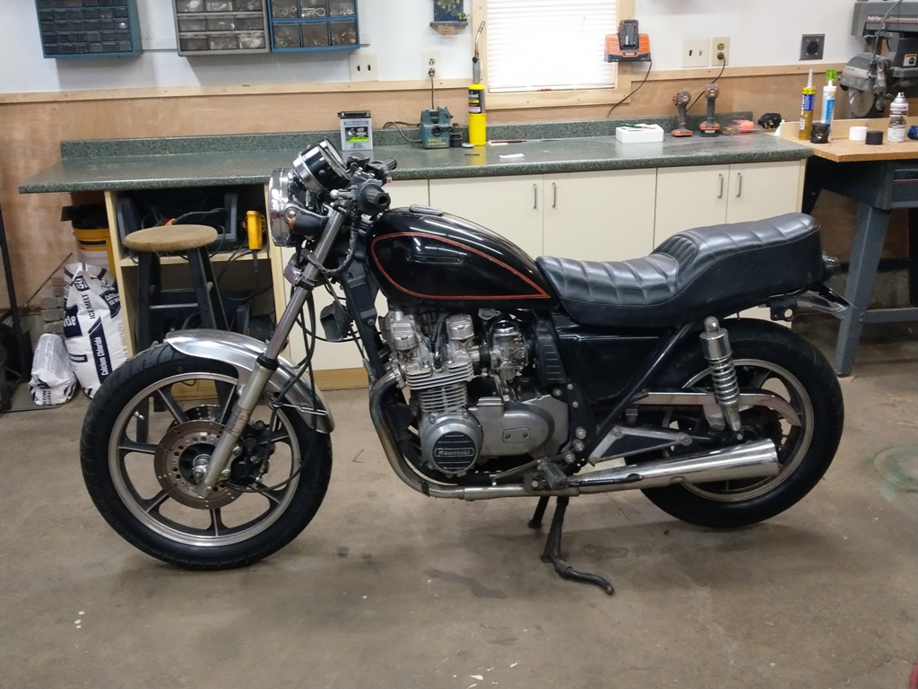

New toys. Just realized that they did not come with new gaskets so I ordered a set that should be here next week.

Got the exhaust on tonight, doesn't sound any louder than stock to me. Put the manifold nuts on a 5 ft lbs, which seems awfully loose.

It may seem loose, but 5 ft lbs is good. The manual calls for 4.5 - 6.5 ft lbs for 6mm coarse threads. I normally stay near the light side of torque specs to avoid stripping threads. Ed
