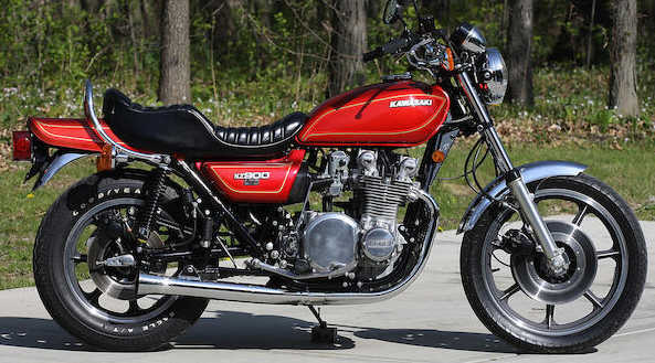

14 Aug 2018 12:44 - 14 Aug 2018 12:45Togoster wrote: Okay, just ran across that 77 kz1000 Speedo cable dumpster fire of a post and realized that my discs are in the rear too so my 900 is a mutt, a mongrel but I don't care about that. .....................
Maybe / maybe not a mutt. I haven't seen a picture of your bike, but in another posting you mentioned it has mag wheels and triple disk brakes. That makes it sound like it is a 1976 KZ900 LTD. If so, you do not have a mutt. The 1976 KZ900 LTD came with mag wheels and triple disk brakes with the front calipers behind the forks. Ed

I personally love the look of the LTD. That voluptuous motor bulging out from under that little tank. This bike has the plain mags with no ridges like on the LTD. It also has the 18" rear wheel. The neck sticker is long gone but the vin is a Z1F-100xxx and not a KTOO.
I'm not all that concerned either way though really. I'm leaning towards just keeping them in the family so I can go riding and work on them with my son. He's not very mechanically inclined at this point but that can be kindled. These are simple bikes to learn on for the most part, at least as compared to the new stuff. Those he'd need to have worked on and that ain't cheap.
