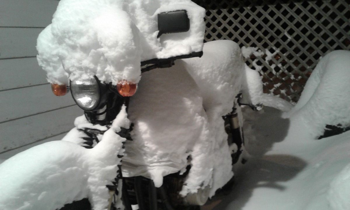

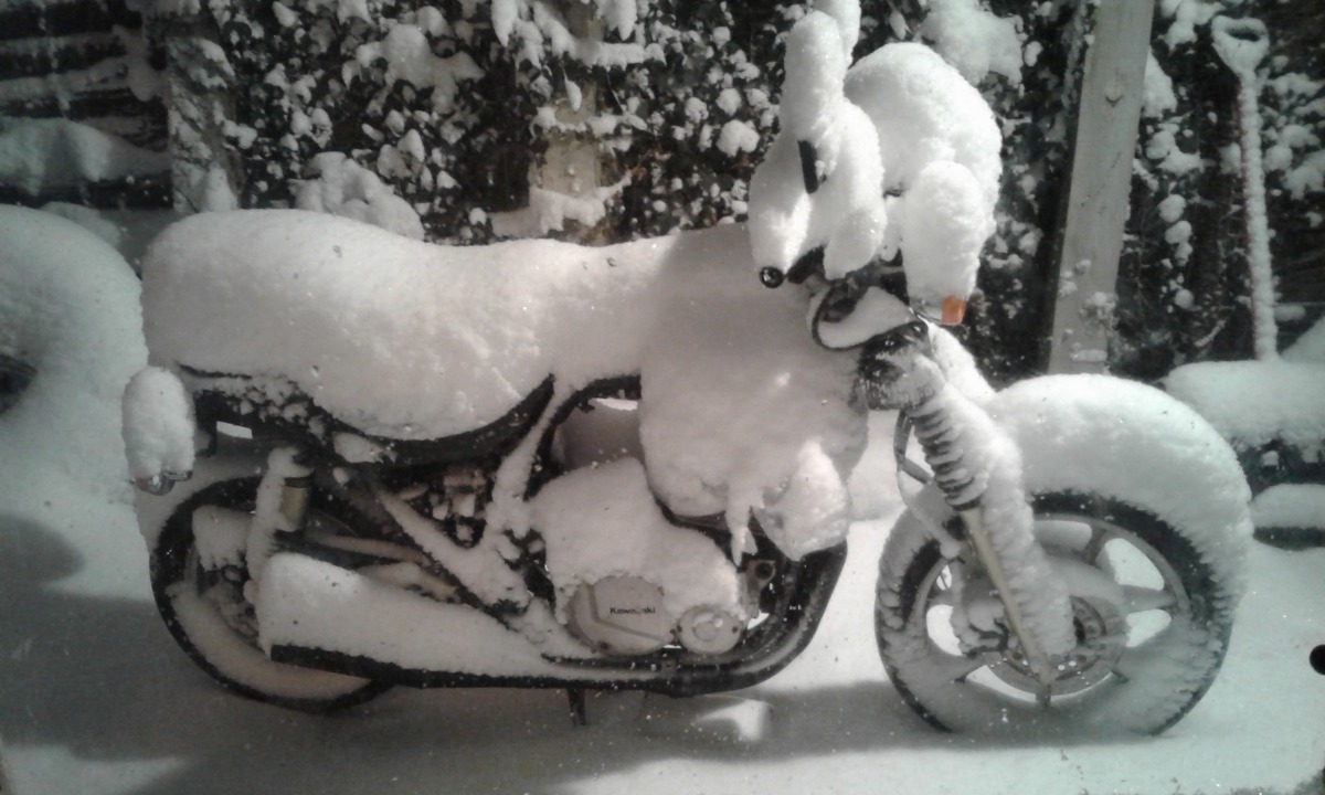

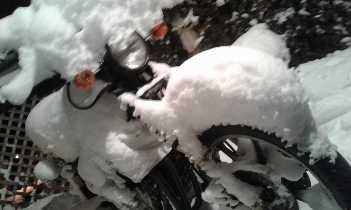

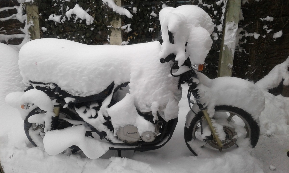

Not even a cheap tarp to keep all that moisture off of it?
- RLBuddi
- Posts: 99
- Thanks: 2
Re: 1982 1100 Spectre ...ongoing project.
16 Mar 2018 19:23
I'd been dinkin around with it, then duty called and was OTR when all this snow came. But I do have a bike cover for it.
