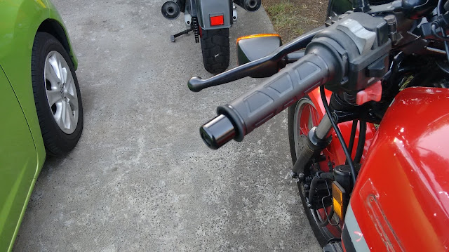

A shipment of good quality bar-end came from the UK. It is $25 and heavy. You can also see the handgrip heater I installed from eBay. Very tidy compared to Oxford and works well too. Good stuff for $20.
