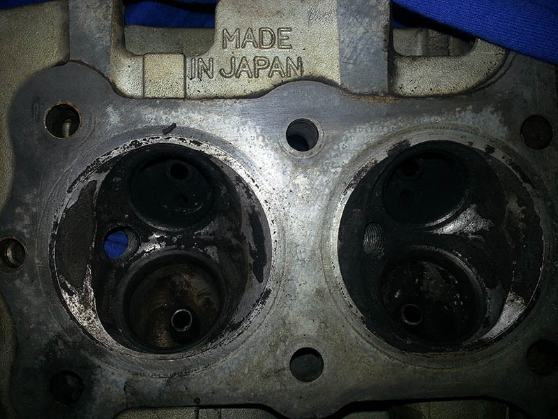

dohc wrote:650ed wrote:eofa wrote:Nebr_Rex wrote: Looks like Wiseco pistons. The head is silver not black, got a pic of the combustion chamber?
Combustion chamber? Did you look at all the pics?
Yes. So can you show a pic of the combustion chamber? Ed
Just to add a few more words, I believe what everyone would like to see is the cylinder head combustion chamber in the area around the valve seats. I believe the GPZ had a superior combustion chamber, with a bathtub cutout, while the J model head had the traditional hemi chamber. Since the head it not black, I think Nebr_Rex is concerned that it may not be a GPZ head.

Like this one.

Yep, that's it. Judging by the shim on top buckets and silver paint you have an LTD
head. Same as the GPz except the buckets. Have you measured your cams yet to
see what you have? I.e. GPz, LTD or aftermarket.
