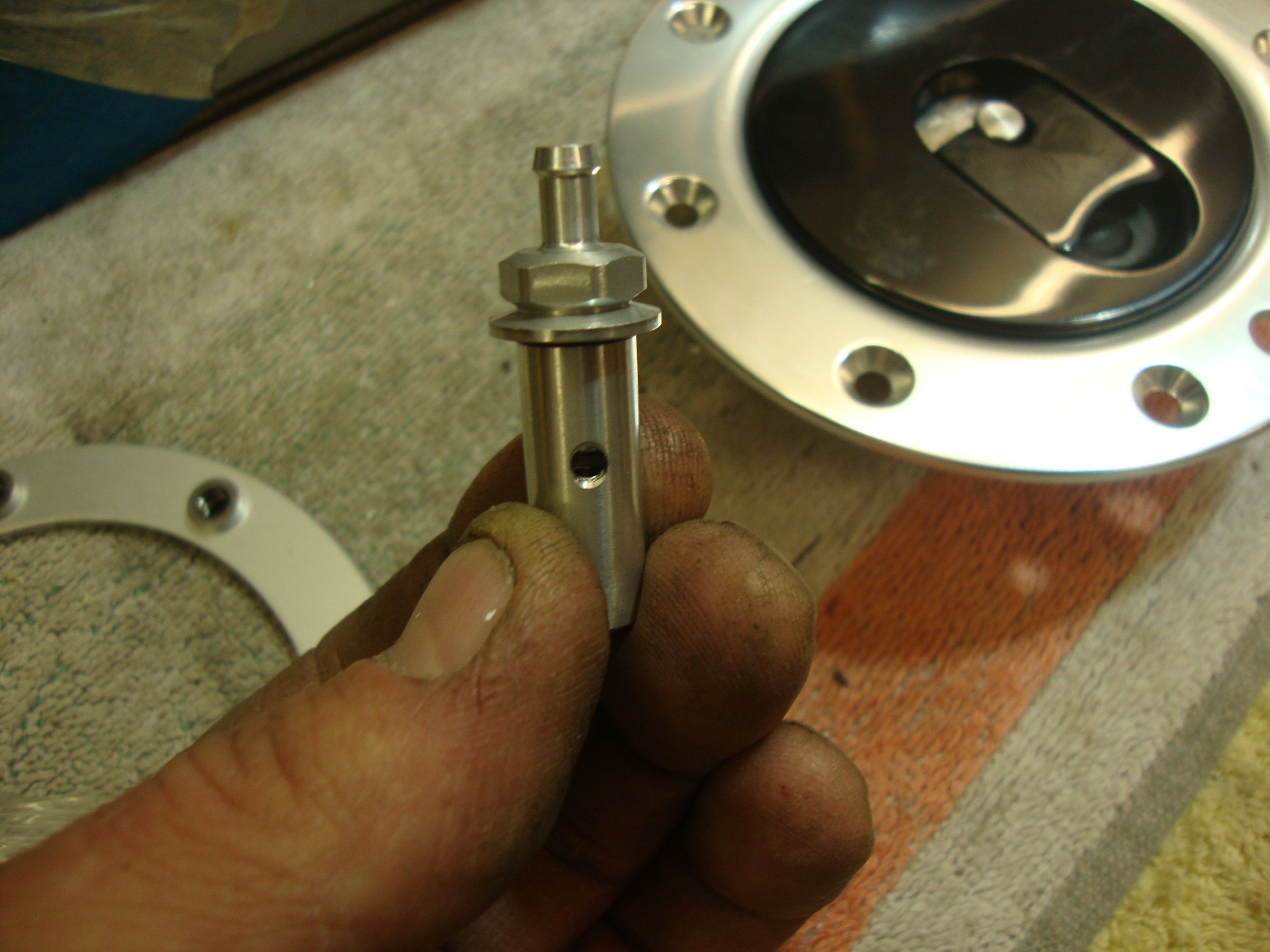

Well,it finally arrived.Again,not the one I ordered (no lock).The quality looks good but I cant recommend these people based on the length of time it took to finally get the wrong one again!
Anyway,I decided to go with it rather than risk returning it and waiting,god knows how long to maybe get the locking one I wanted.
This is a sealed cap (hopefully) with a seperate breather valve.Ill run a hose off that to somewhere up by the clocks, a la early GSXR or dirtbike tanks .
Then my camera battery died.So,no pictures of the fitting process but ill post some fitted and finished pictures soon. It was pretty straight forward anyway and Im happy with how it came out. Now I can start thinking of paint.

New tank cap fitted
So,I took it out out again for cleaning and derusting the tank.Going with the brown vinegar again.Heres how it looks

How do the nuts stay in the tank, if you see what I mean, I can see that you need to cut a hole for the cap and drill holes for the bolts, but how do you get the nuts on the bolts.
I'm interested in fitting one of these to my J
- davido
- Posts: 1582
- Thanks: 291
Re: Re:CSR1000 Project Build
10 Oct 2016 13:10 - 10 Oct 2016 13:11
In the first photo of the previous post you can see the a 'C' ring. This has the nuts welded onto it. It goes inside the tank and you bolt the main body down to that ,sandwiching the tank skin and a rubber gasket in between. The opening in the 'C' goes to the front and allows the breather valve space to be mounted. Hope that makes sense.
