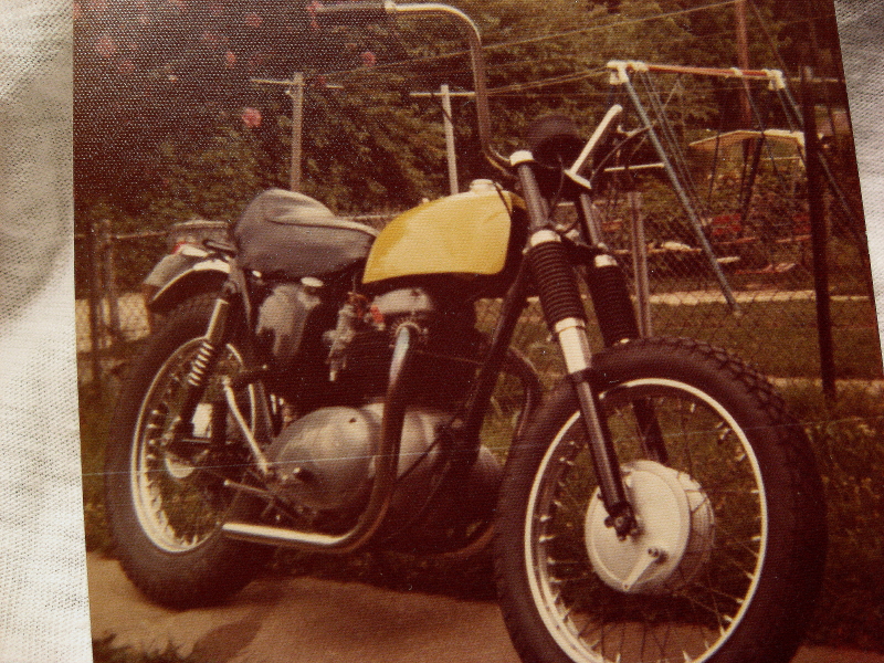

Just bought this bike a couple of days ago for a small amount :laugh: . Now I want to make it look a little better I dont like the seat on it and take out some of the old stuff of it. The photo is from the person that owned it before me and when i got it, it was a basket case. The second photo is what i want it to look lie
. Wish me luck if you got any advice please don't be shy!!!!

Welcome aboard. I recommend you keep the front fender on it; you'll thank me the first time you get caught in the rain or ride through a puddle. Guess how I know? :laugh: :laugh: :laugh: Ed

I agree. That Ltd fender is nice and small, at least. I think the bike will still look good with i. Plus it will help save your steering bearings, which are a pain to replace, not to mention keeping crap and water from the top of your motor and coils.

My last bike a 03 z1000 I went fender less sure you get soaked in the face and visor when it rains.. But the look is great many compliments from other bikers.. Screams street fighter.. Also not many luv or even ride in rain.. I do.. A small drag style chopped fender offers a brace and limited protection..
An old biker told me to always keep 2 shop rags.. You tie them end to end if it rains and loop them through your forks so they just barely touch your tire and it's just as good as a fender.. Rainflap

Most fenders have a brace in them. Some LTD forks are a bit extended and flex more than standard but even standard can flex you right into a tank slapper or just have a headshake that is difficult to get rid of without a brace of some kind. (ie braced fender, fork brace or tweek bar)
Personally I would look for a nice fender. Your bike I believe has a nice small fender but if it is not small enough you can opt for a gender brace $$ or look for a SR fender that had a removable fork brace built into it and just mount the brace. I am also a fan of keeping the motorcycle and myself as clean and dry as possible. I own 1 Bobber and do not ride it in the rain as I do not like a skunk stripe from the back wheel either. All my other bikes are standards. Good luck it's a great bike.
