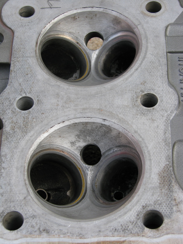

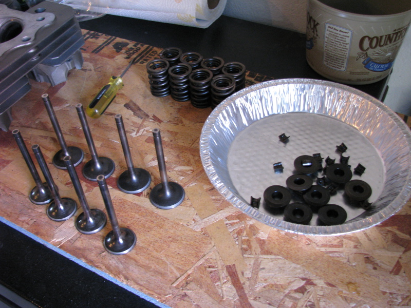

And now another month has gone by, but I finally got it finished up! I lapped the valves last night, which went very smoothly and left a nice surface on the seats, but this got me thinking about your earlier question, swest... And I realized I did NOT actually sandblast the valve seats. I left the valves in place as I was cleaning the head, and didn't take out the valves until I had all the carbon cleaned out of the piston dome. I guess I was thinking ahead there.
Anyway, so I finished cleaning the valves and then hosed down the head to remove the rest of the lapping compound, don't want to leave any of that grit remaining inside the engine. Today I then had to go through all the individual pieces and clean the sand off of everything. It was time-consuming, but required. As you can see in the previous pic, I didn't get the valve seats dried completely, so there was a little surface rust this morning. It wiped off easily though.
Once everything was cleaned up, I broke out the C-clamp again and started reassembling the valves. It took a bit to figure out the technique on the first one, and I found a flat dental pic helped a lot in getting the pieces in position, then it went pretty smoothly until the last one. Of course there always has to be one that's stubborn, but I finally got the pieces to seat in place.

Did you get pics of the seat area. They can't be too wide or too thin.

I'm not sure what you mean? All the valves are shown above, and all the contact areas in the head look identical to the close-up shot above. I barely had to touch them to get a clean contact surface between the two. It really looks like someone had done some previous work and only rode the bike a little before I got it. I didn't even bother swapping the little rubber cups on the top side of the valve stems because the ones in there looked almost new.

I think what SWEST (please correct me if I am wrong) is referring to is that just because you have what looks like a good seat area on the valves AND head ..... it's not necessarily a good thing. If the seat area is too wide OR too narrow the valve will not seat properly. I do not have the manual in front of me right now but the correct seating area is described in there. If I remember correctly (which is usually NOT the case), There are 2 angles used when CUTTING the valves. Being as how you lapped them, as I did, there probably will not be an issue as you are not removing allot of material. The only thing I recommend is checking the valve clearance AFTER the bearings and cam are in place and torqued. OK now my project questions lol ... Sandblasted my engine crankcase halves, oil pan, outside of cylinder fin area and my fingers lol. Not sure why but the gun kept clogging, hasn't before and used a new bag of medium grit garnet like before. Going to try some glass beads later because I'm not happy with the results for painting. I also got thinking about our previous conversation about NOT baking in my smoker (Good advice about the oils from the meat in the paint) .... the wife is not going to let me do it in the oven SOOOO after a couple of cold ones I thought OK, wrap it in a couple layers of foil OR a roasting bag and then put it in the smoker to bake the paint. I'm not sure if baking the paint is worth it so I am taking your word that it is worth while and worth the time. If you need specs on the valves, please let me know. I want to thank you for all the info and advice you are putting on here. You are saving me and some others allot of money and headaches. Be well, stay warm and be safe.

My thoughts on the matter are that if there had been noticeable wear on the valve seats, the lapping process would have shown an uneven ridge, pock marks in the seat area itself, or something else. Instead what I have is a lapping job that took literally only 2-3 minutes per valve (and a lot of that was fighting with the tool not sticking well to the valve heads) and left a very clean, even surface on all the parts. That's why I mentioned again that I really feel someone has done a recent overhaul on this engine, because the parts I've been working on show signs of new seals and very minimal wear.
