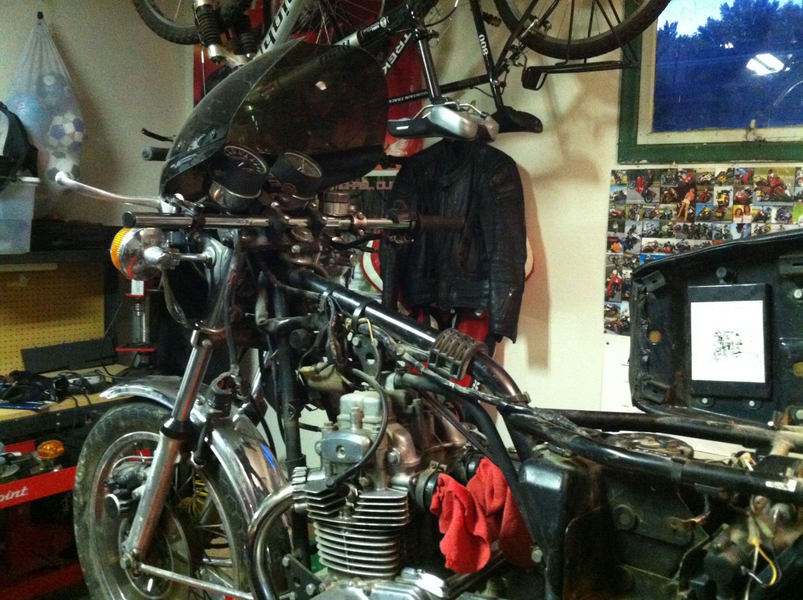

I've got the carbs soaking so I thought I'd mock up the fairing with the drag bars. Kinda wish I would have got bars with a little rise in them...got an issue with the brake line being too long. Anyone know where I can get shorter one or another model line that would work?
