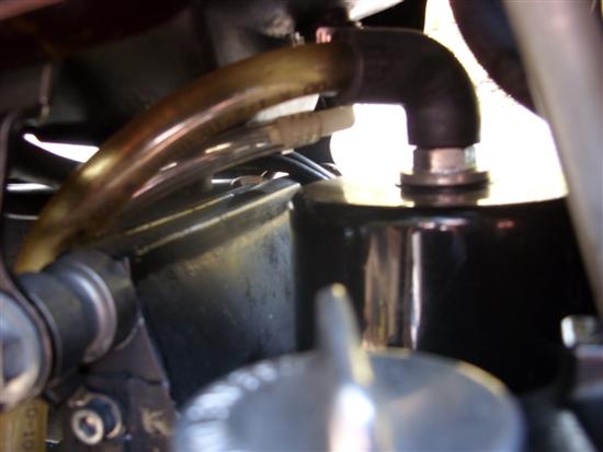

Fixed float bowl issue. Now it appears I am just pissing oil out of my crank case filter. I am running pods and do have a tube and filter attached to the breather hole in the crank case. I tied a rag to the filter and when I got the bike to 3000 rpm stationary it just started spewing. I didn't think this was an area of the bike that was under pressure and would release oil in such a manner. Any ideas as to why it is just spitting out the top of my crank case??
Bike was on side stand and stationary when i reved to 3k and got my discovered where the leak was coming from. I was just warming the bike up to take it for a spin.
Hopefully, you guys have some good news and a relatively cheap and not to difficult solution for me!

30 Mar 2013 14:21 - 30 Mar 2013 14:23Rory Byrd wrote: Fixed float bowl issue. Now it appears I am just pissing oil out of my crank case filter. I am running pods and do have a tube and filter attached to the breather hole in the crank case. I tied a rag to the filter and when I got the bike to 3000 rpm stationary it just started spewing. I didn't think this was an area of the bike that was under pressure and would release oil in such a manner. Any ideas as to why it is just spitting out the top of my crank case??
I don't know a ton about these bikes but did you over fill the oil? I believe the sight glass has notches on it for max and min oil levels. Edit: read this kzrider.com/forum/2-engine/549111-1979-k...lling-from-crankcase

Would sniff-test and check crankcase oil for fuel contamination.
Am not a fan of the imo useless little filters on the crankcase breather outlet, that may actually impair breathing as it accumulates oil, dirt, water, etc.
Would toss the filter, get the issue corrected, and route a hose from the outlet to exit underneath the bike.
