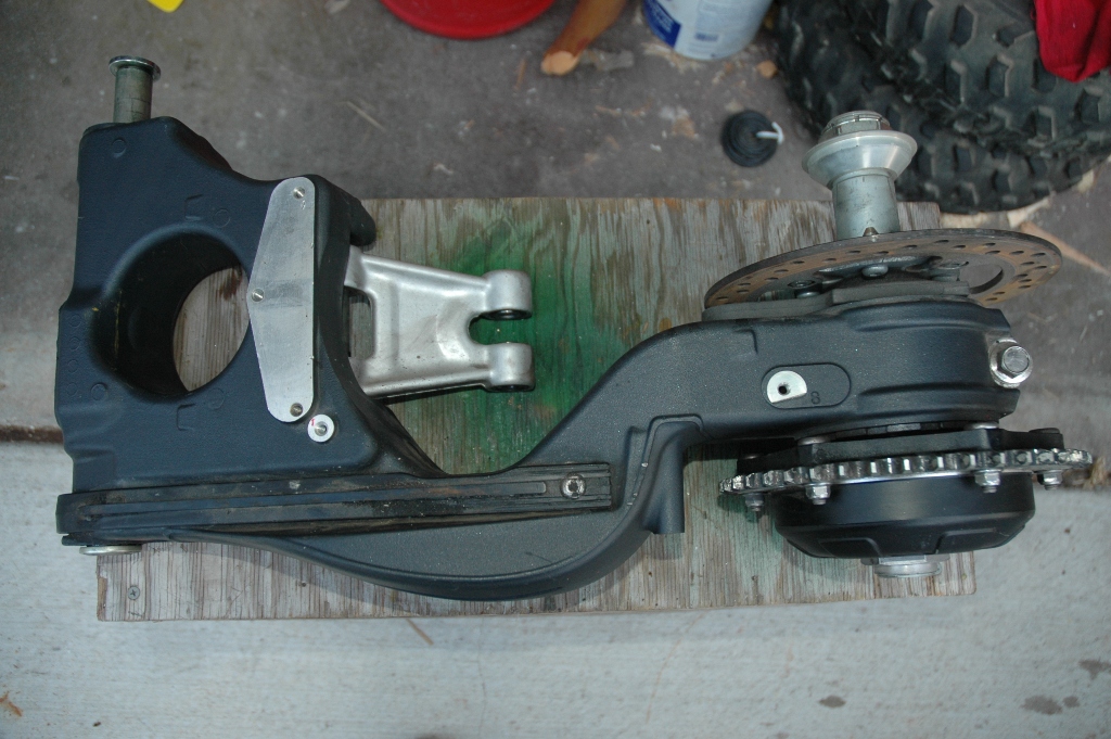

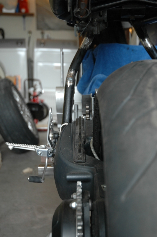

Hmmmm, You've got me a little confused Hollywood, but to be fair, my swingarm installation is mostly documented in a seperate thread. If you hadn't read that thread through, then you might not have a clear picture of everything involved in my particular swingarm swap. I think I've got the jist of what you're trying to say. I am curious about your offset rear sprocket, now that you mention it. Does it really have .75" of offset to it? If it does, then SWEET! If not, you may want to recheck either your math or your measurements. I would hate for you to have to buy a second sprocket like I did because you got it wrong the first time (yeah, that really happened). In the end, I used a low tech string line against the rear sprocket to figure out my offset needed.
I do not have the luxury of flipping my rear sprocket as you can see:
In this pic you can see how much offset is required (thats the stock CSS up front):
My swingarm is a svelt 285mm at the pivot, thats why I have to jump through so many hoops

21 Mar 2013 00:05porchev914 wrote: Hmmmm, You've got me a little confused Hollywood, but to be fair, my swingarm installation is mostly documented in a seperate thread. If you hadn't read that thread through, then you might not have a clear picture of everything involved in my particular swingarm swap. I think I've got the jist of what you're trying to say. I am curious about your offset rear sprocket, now that you mention it. Does it really have .75" of offset to it? If it does, then SWEET! If not, you may want to recheck either your math or your measurements. I would hate for you to have to buy a second sprocket like I did because you got it wrong the first time (yeah, that really happened). In the end, I used a low tech string line against the rear sprocket to figure out my offset needed.
I'll look for the thread tonight so I understand the situation better. Looking at yours from the back mine seemed pretty close to be as bad yours though because the laser went past the case guard and yours looks to be close to pointing to the same spot.

Ok I looked at it, page one had your sprocket answer. You need to take advantage of a two piece rear sprocket just like what I posted in my offset thread. In pic 1 below this setup has a negative offset rear sprocket.
Upon further examination, you already have a two piece sprocket setup below, just setup with a positive offset rear. This is what I would do. Copy what I did!! :side: :woohoo:
If your combine your sprocket and sprocket mount you actually have a positive offset rear sprocket. You could try mounting the sprocket on the back side of the mounting plate but it looks like it will rub or at least the chain might on the swing arm. So that then gives you a couple options;
1. Measure to see if a 520 chain and sprocket would fit, I can help you with that if you do some measurements.
2. Machine the outside of the sprocket holder so the chain and sprocket wont rub, then put washers on the positive side for the bolts to make up the difference.
3. Grind the swingarm where the sprocket and chain would rub so it doesn't.
I bet if you flip it so you have a negative offset rear you will barely need a counter shaft front sprocket at all!

Yes sir! The second pic you will have to test to see if makes it too negative of an offset. If it does that you would to machine the inside (I said outside earlier my mistake in option 2, I meant inside).
Have a look, much better than a huge CS front. :whistle:

Hollywood, I took a closer look at your proposed solution. I can honestly say I never even saw it as a possibility until you pointed it out. That said, I do not believe it would be an economical way to go. Using parts as is (stock 530 chain, stock Triumph sprocket) placing the sprocket on the inside of the flange would put the chain .1" into the tire. I'd have to have .2" machined off the inside of the drive hub, which would only leave me with .25" of material to bolt it to. In this scenario, I might be able to buy an off the shelf 530 offset sprocket, but I would still need a .639" offset. A 520 chain would lessen the amount of machining required and effect a smaller offset still, but it would also necessitate the manufactuing of a custom rear sprocket as well as have another custom front sprocket made. Of course none of this takes into account that I would have to disassemble the entire hub just to R&R the sprocket. With the first option I am still on the fence of needing an outboard support plate.
I think that at this stage, I will stay with my current configuration. I have a counter sprocket that matches the chain line, the bearing support has been fit and mounts welded in, and I don't have to do any surgury on the SSSA hub, wich I am a little reluctant to do. The business end of my swingarm has alot going on in a small space :lol:
