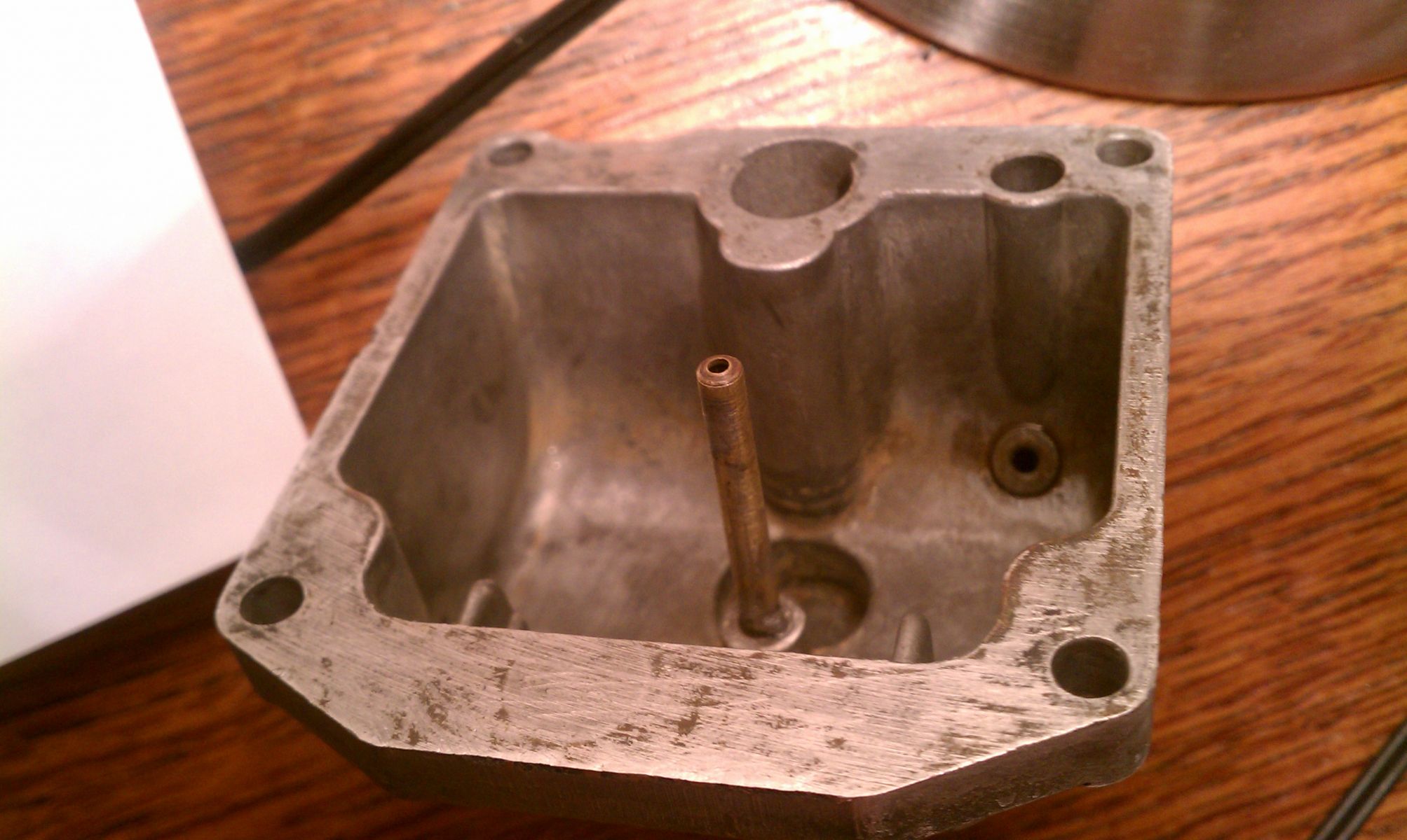

I have a 1981 KZ440. I thought my float level was off because fuel was leaking out the overflow tube. I opened up the carbs and one of the overflow pipes is cracked right down the middle. The other has a small hole. Is there any way to fix this? Is it even possible to find new bowls? I read online about someone soldering the crack, will that really work safely? Thanks.

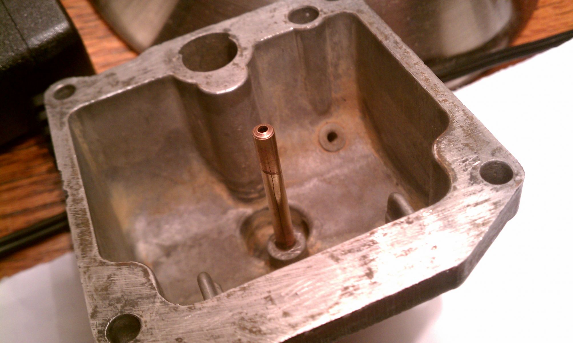

Some people put a piece snug fitting tubing over it. Seems the easiest way. Myself, I took suggestion from here and soldered it. Seems more permanent IMHO.

What are the steps for soldering it? Thanks so much that's exactly what mine looks like.
