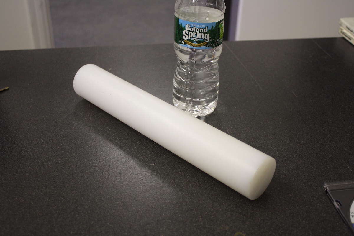

If you want lower than that, you need to fab up some limiters out of UHMW polyethene rod. Buy a foot of it (McMaster Carr) in a diameter smaller than your shock ID and chop off a coupla pieces on the band saw or lathe.
