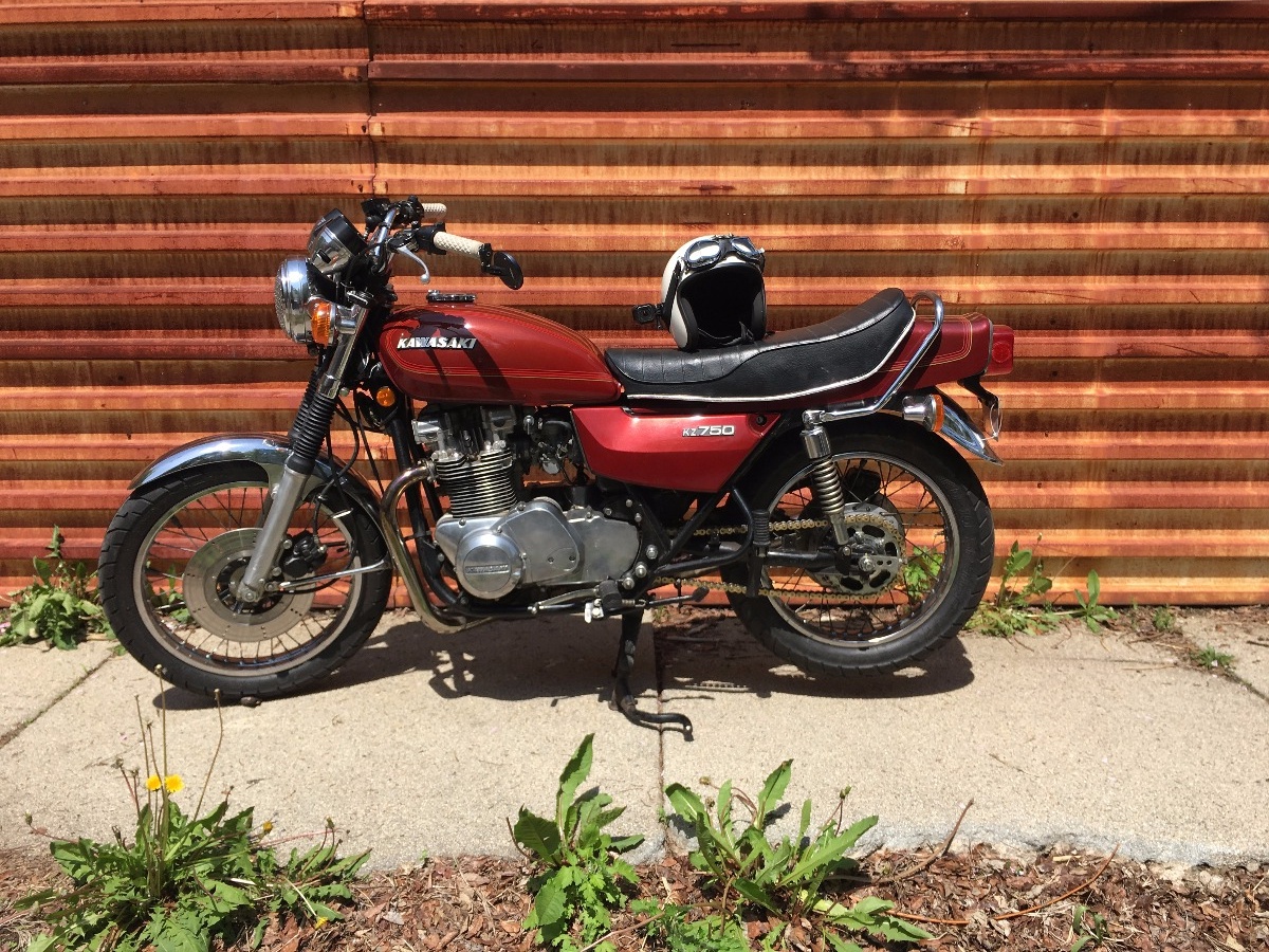

Went scrounging online for parts and got a JT Sprocket and chain. As of today Im back on the road and the bike runs great. It was 85 degrees F today, or about 29C and i had a great ride. Here is a photo of the bike. I took it today before I went riding.

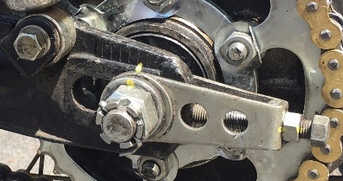

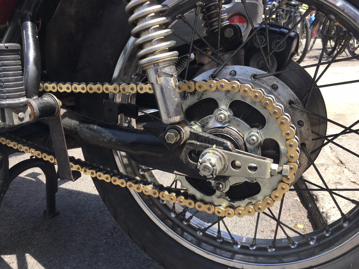

That chain adjuster is adjusted nearly all the way toward the outer end of the swing arm. Normally, it would be nearly all the way forward, especially with a new chain. Are you sure the chain has the correct number of links? Ed

650ed wrote: That chain adjuster is adjusted nearly all the way toward the outer end of the swing arm. Normally, it would be nearly all the way forward, especially with a new chain. Are you sure the chain has the correct number of links? Ed
Im going to count them today. There should be 106. It could be 110. If it turns out its 110, what are the repercussions of running it as is, with 4 extra links?

You don't have much adjustment to compensate for chain stretch.

If you are going to take out links do it now. Does it have a master link? If so move the wheel all the way forward, disconnect the link and see if it will fit the next link without cutting it. One tooth larger countershaft sprocket will give you more adjustment room if you can't take out a link. Same with a larger rear sprocket.

SWest wrote: If you are going to take out links do it now. Does it have a master link? If so move the wheel all the way forward, disconnect the link and see if it will fit the next link without cutting it. One tooth larger countershaft sprocket will give you more adjustment room if you can't take out a link. Same with a larger rear sprocket.
Yes it has a riveted master link. I suppose i can take that off. BUT will i have to take the covers off and whatnot or can i do it while the chain is still on the bike (take the link out I mean)
I counted the links on the chain as its on the bike. Its OEM spec 106 links. I wonder why it "seems" longer. Hmmmm.

Maybe the sprockets are smaller than stock?

loudhvx wrote: Maybe the sprockets are smaller than stock?
I bought this same sprocket which lists it as stock. If you see anything wrong let me know, but I think sprocket size is 530 38T

If your rear sprocket is smaller, your takeoff will suffer but the RPM's will be lower at speed. Same as if you had one tooth larger front sprocket. On my bike (630 chain) stock is 15/35. It was great for takeoff but at 70 I was at 5000 RPM's. With the 16 countershaft I';m at 4000 .or a little over. I didn't like taching at 7000 at 90-100. Now it purrs at 90 with more to go,:woohoo:

After checking several sites, the manual and bike bandit, which references the original manual, it seems the appropriate number of teeth on the rear sprocket is 38, which is what i have on it. Im not too concerned about it. If it happens that the chain stretches beyond what can be adjusted, i'll change it then. I have 4 bikes and cant get bogged down. I had a great time on it this weekend and will continue to ride it. Or in other words, I cant be bothered lol. Whats done is done.
