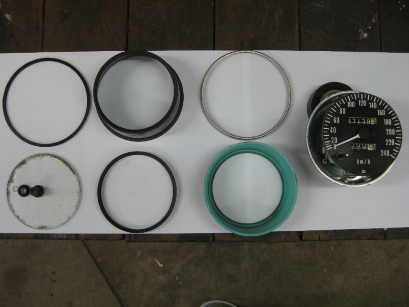

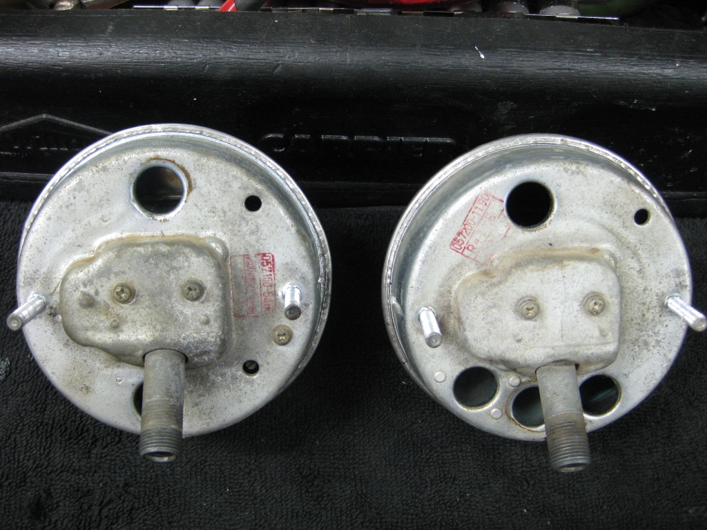

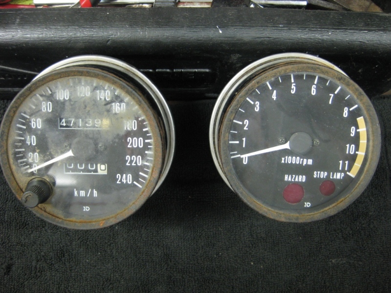

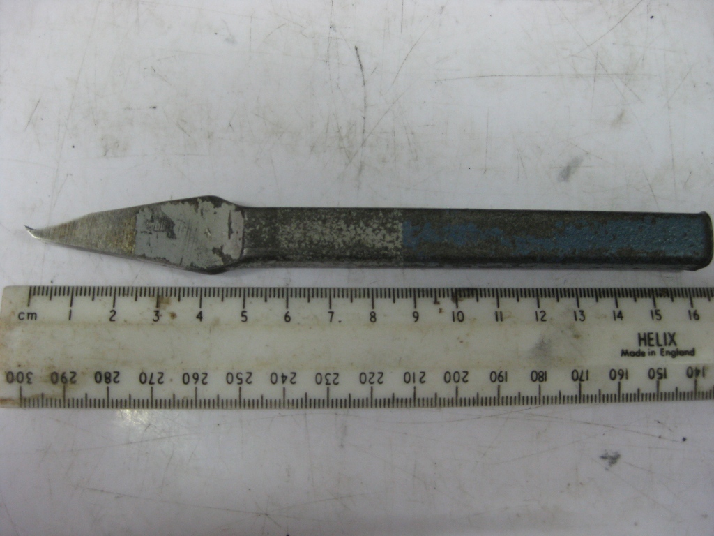

16 Nov 2014 20:42 - 16 Nov 2014 20:45Started pulling my clocks apart over the weekend - . Made a tool to open the clamping rings - see attached pic and after about 2 hours each had both clocks apart with little or no marks/damage to any bits. You need to be firm but consistent each time you go around each ring (10mm at a time) levering the ring away from the clock body so that it doesn't distort or bend/kink. Not so critical on a Z1-R, this ring is concealed under the fairing. Point to note is that the tripmeter reset knob is on a LH threaded shaft so don't bugger it by trying to pull it off - it's not a push fit! Both clocks are mechanically ok - just need to repaint the covers, clean glass and redo the red-line area of the tacho - have decal from ReproductionDecals.com. Have posted more on this already on Australian Kawasaki Sports Riders Club website. Have tried to put multiple pics here but nogo so will put on a couple at a time.

Haven't had a go at getting the needle off, but I've read that this is a firm push fit and something like a couple of teaspoons under the boss of the needle with even pressure upwards is the go. Need to protect the face of the clock so you don't mark/gouge it, also do this job inside somewhere as I've heard that the needle flies off once released! My apologies for not being more specific about where I posted more pics - Oz website is
www.ksrc-au.com
. Another pic of the disassembled clocks - one or two more to come before I get into the repaint and re-assembly
