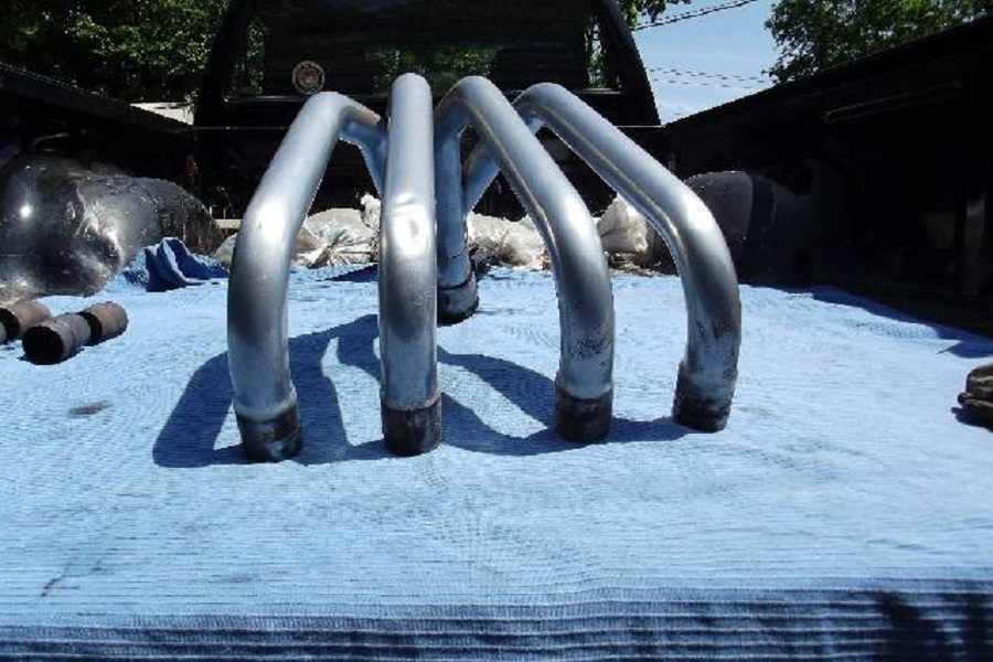

I have done a few now.
It all depends whom does the work. My powder coater is a mans man pro, very experienced and only puts out very best work. He bakes it on in a huge oven.
3000 degrees coating.

This is my Basanni Headeer pipe that I had it coated in 1988 in silver, & on the bike before I switched it for a Vance & Hines in 2010, because the chrome rear was peeling & flaking, NEVER discolored !! , only a spot on the bottom from oil that had burned on it , because I couldn't see it
