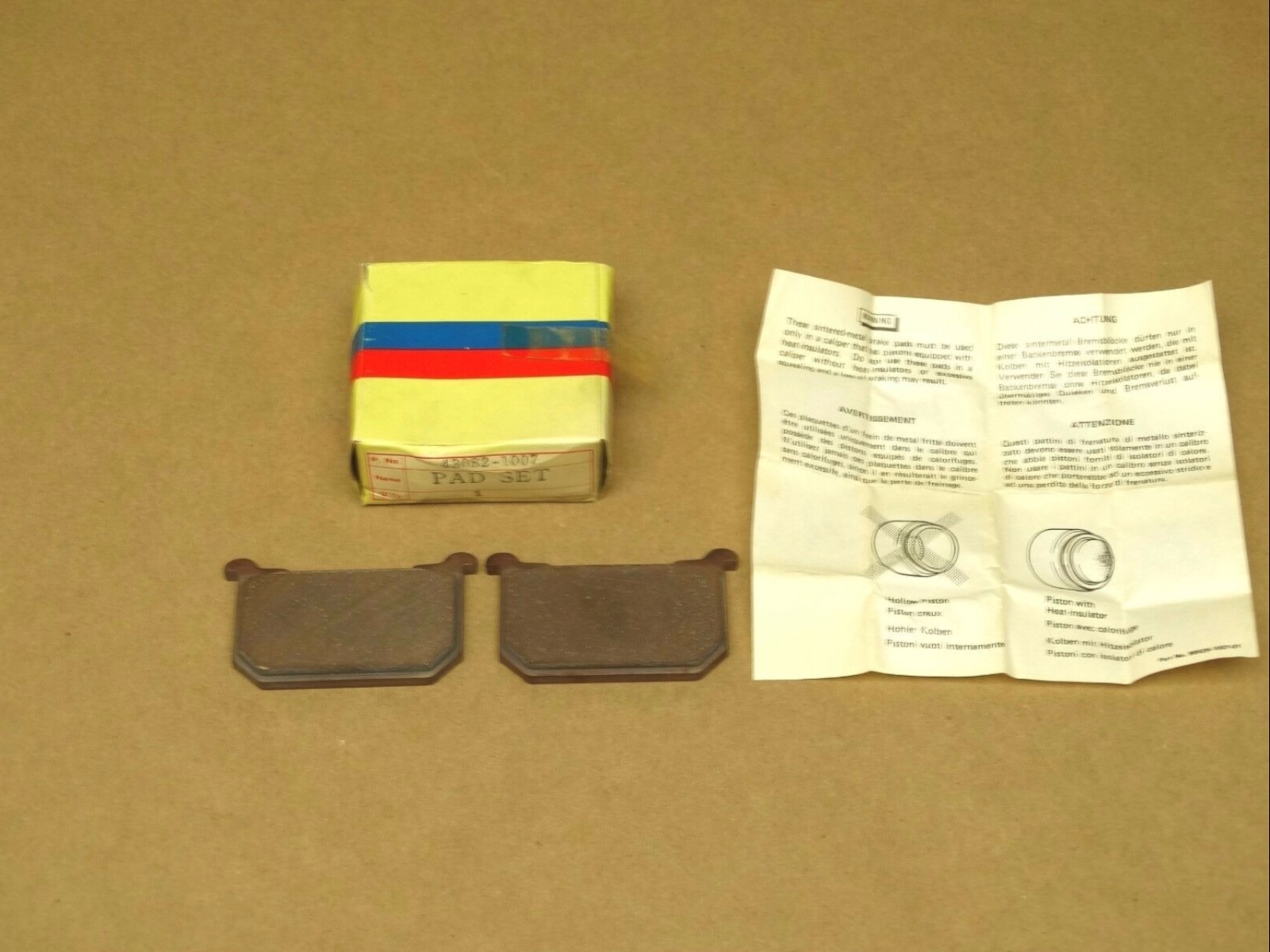

Here's the brake pads attached. I don't know exactly where to get the parts number or find exactly where a listing of the friction material would be.
I'll try to get a picture of the issue when I can, unfortunately, I keep my bike in a friend's garage where it's safe.

No eBay APP ID and/or Cert ID defined in Kunena configurationHeres a try... contact this seller and ask to measure his pads... or for the money just buy OEM pads...
- Thanks: 1851
Re: Brake Pad Replacement - KZ750
29 Jun 2020 11:21 - 29 Jun 2020 11:21
Without knowing you specific bike, I found this photo of OEM pads. Next to it is a pamphlet that looks to identify different pistons possibly used in the caliber. Possible there are different pads relative to the piston configuration?

Those EBC pads are fine. If you can't get the caliper installed with those installed either the piston isn't pushed back properly or the caliper is binding on the sliding pins.

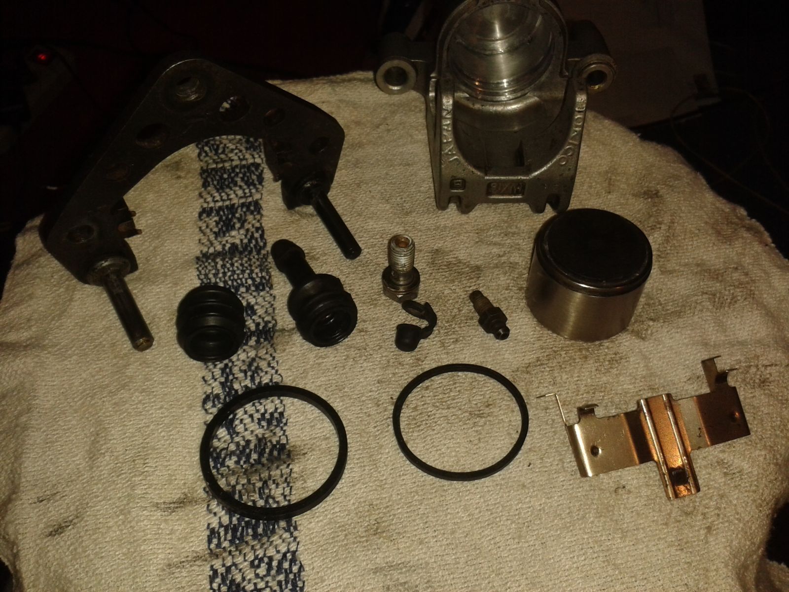

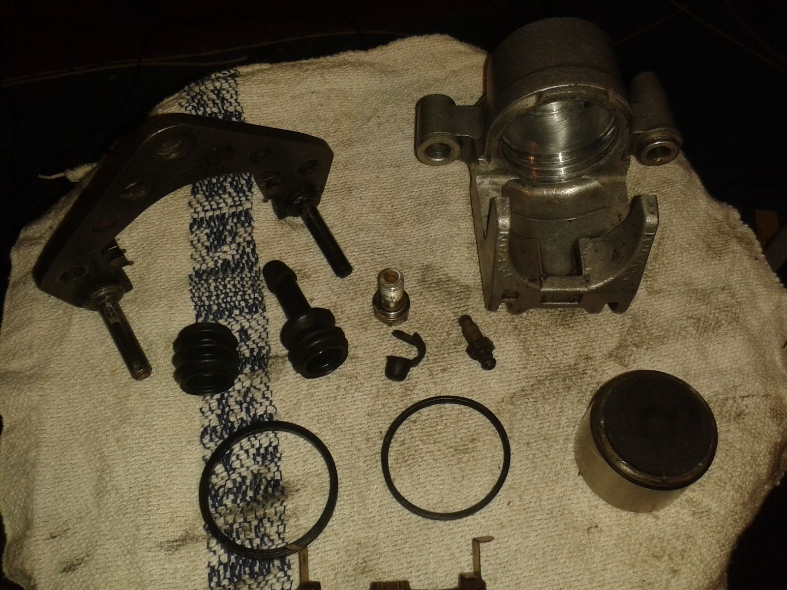

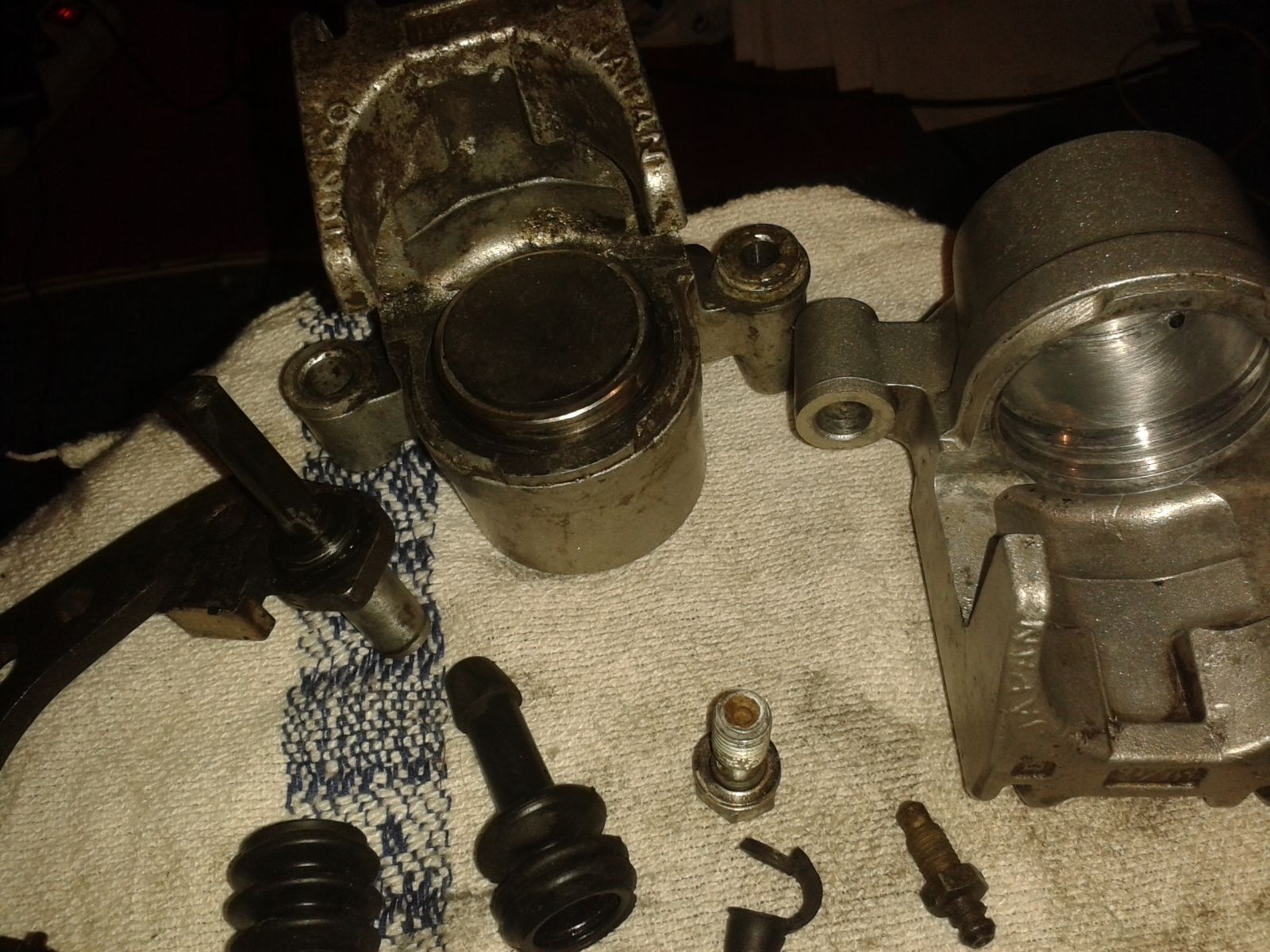

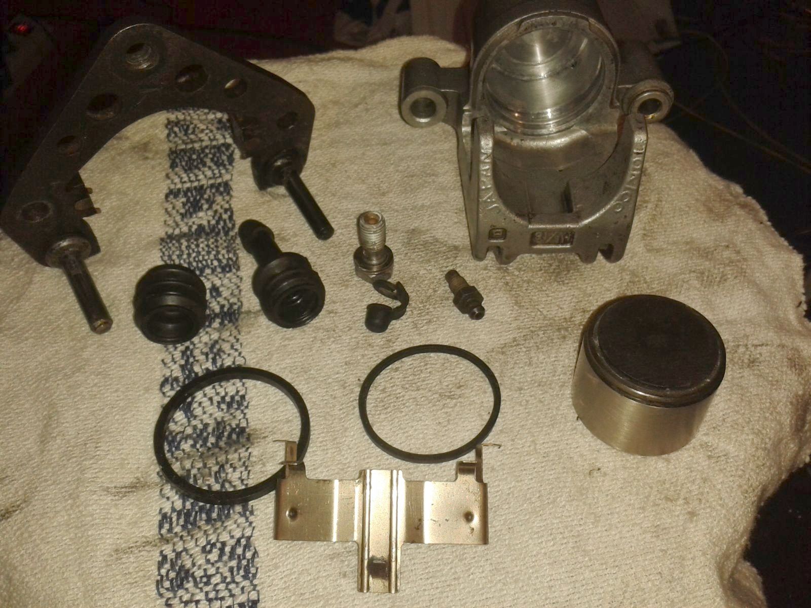

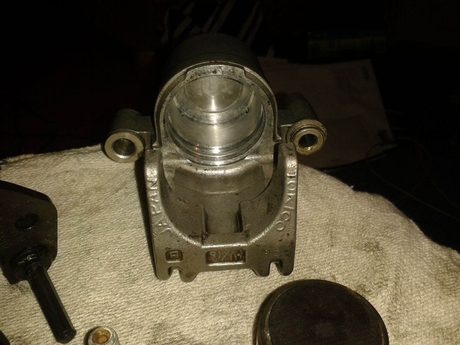

You have to give all caliper parts a good clean!!! This required a total disassembly of all parts!!!
You will be surprised what you will find inside the caliper, don“t trust the first view from oudside!!!
