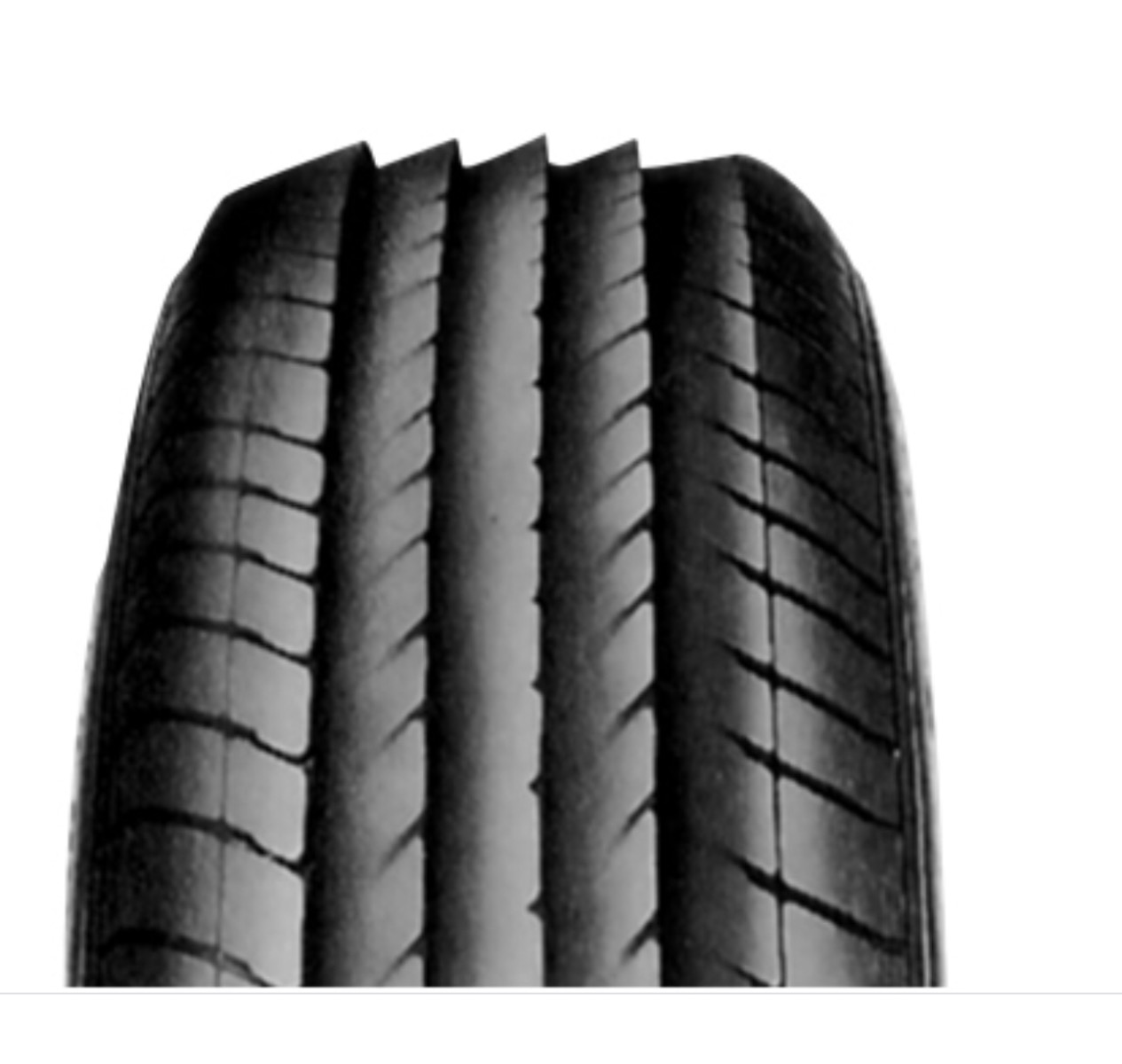

31 May 2020 17:33
Now that you have the belt aligned, look at the notch on the swinarm and compair them from the right to the left. They should be on the same alignment marks. That will confirm your alignment. As for the pull it could be a bad wear pattern on the out of alignment wheel. You should be able to see the wear pattern on the tire. Look for feathered edges. I’d say if the noise is gone you’ve corrected the problem. Cautiously ride the bike a while and see if the pull goes away. Use extreme caution and avoid any wet roads or rain. If the tire is worn it could be a very greasy ride. Give it time to correct
