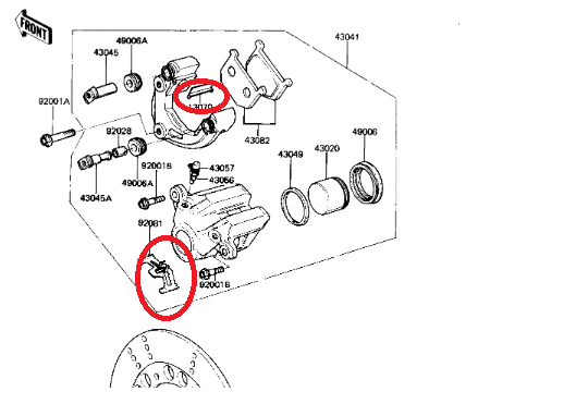

Probably a dumb question but are there any small parts missing from the assembly?
I'm thinking specifically of 92081 which Kawasaki call a spring pad and which the Haynes manual calls an Anti Rattle Shim. Also the other item in red circle. Kawasaki - guide. Haynes - shim. These can easily go missing during brake service but I'm not sure what effect their absence would have.
