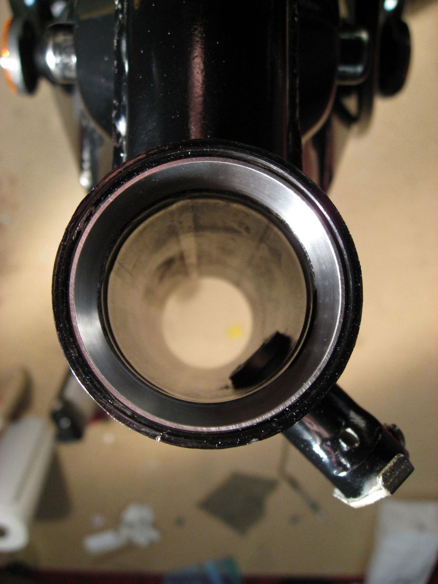

Hey guys,
Starting to reassemble this project of mine. I've replaced all the bearings throughout the bike and all seem to work fine so far. I've come to the stage of mounting my fork clamps and noticed that the upper bearing has a small gap between the dust seal and the frame. None of the actual needles are visible but probably only sitting under the frame by 1mm. Should this sit lower down?

I bought an Tapered Headrace Bearing Set from All Balls. It came with two oil seals, one fit neatly over the bottom bearing and one neatly over the top bearing. It sits pretty snug to the bearing, adding only maybe 1mm to the total height. I didn't remove the upper race as it was still in really good condition, is there a possibility that they are slightly different? I've put the cap on and i'll attach a photo and also one of the same kit as I purchased.

If the bike had ball bearings in the steering stem it had ball bearing races. They definitely are different than the races for the tapered roller bearings. So if you installed tapered roller bearings you needed to remove the ball bearing races and install the tapered roller bearing races. If you did not and if you don't install the correct races you will have problems. Ed

Install the races that came with the kit. Do NOT mix different brand parts.

14 Sep 2018 01:39650ed wrote: If the bike had ball bearings in the steering stem it had ball bearing races. They definitely are different than the races for the tapered roller bearings. So if you installed tapered roller bearings you needed to remove the ball bearing races and install the tapered roller bearing races. If you did not and if you don't install the correct races you will have problems. Ed
UPPER TAPERED ROLLER BEARING RACE
LOWER TAPERED ROLLER BEARING RACE
It had already been converted from the ball bearing setup to the newer tapered style.
So both the upper and lower fork section have 3 parts to my understanding. The bit that is hammered into the frame, pictured above(which is the part that I left in as they seemed in perfect condition) The bearing, and the oil seal. I only replaced the bearings as they were damaged in the period that they were taken out so the frame and fork parts could be powdercoated.
I'll take it apart tomorrow and shoot through some photos. The installation is the same as in the video linked above, and seeing as the part numbers match on the bearings I find it hard to believe that although potentially a different brand, they would differ. I didn't want to belt out the roller bearing races as there wasn't a good edge to get something in to hit them out , but worst case I guess ill have to give that a shot too!

The easiest way to get the tapered races out is to tack weld a washer or pipe to the inside of the race to give you a lip to hammer on.
The really slow a tedious way is to use a dremel with a tiny cutoff wheel to cut it out. This way can damage the frame tube so you have to be extra careful and extra patient. I've only removed one set of tapered bearings, and this is the way I did it. It took hours to do the whole job. I will be welding next time.
