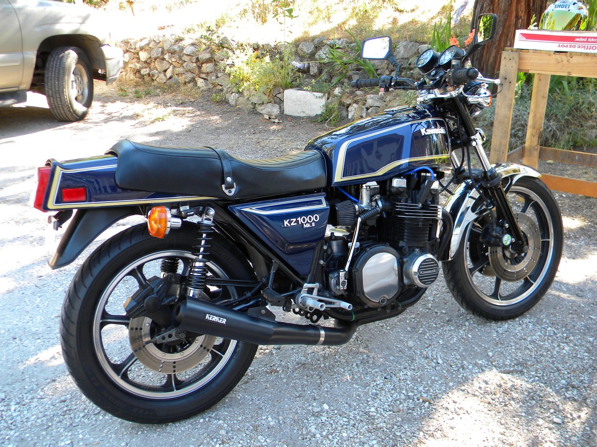

i did
and those ones in the link look softer on the shoes with the rubber tips and pegs than the all metal knurled ones....i had to grind on the under frame weld in a spot to get one side to go on right,,,by one of the triangles not too critical in that spot really ,if i remember right...not too much but enough to piss me off...that was on a MKII frame though...diff a tiny bit i think here and there.....they are really cool...make sure to push thick grease in all the fittings and in the holes where the taroz actual pegs run through the foot linkage and bolt to the black hangers ...it tightens the peg bolt there and will start shifting hard ...even new...i snapped the linkage couplers after a few weeks, brand new, once greased super good it shifted better than new and no more snapped parts to replace....they are really good ,but the all metal ones mark up your toes and eat the sole right off of footwear...imo
also that site in the link sells all the replacement do hickies and ships em fast.....
