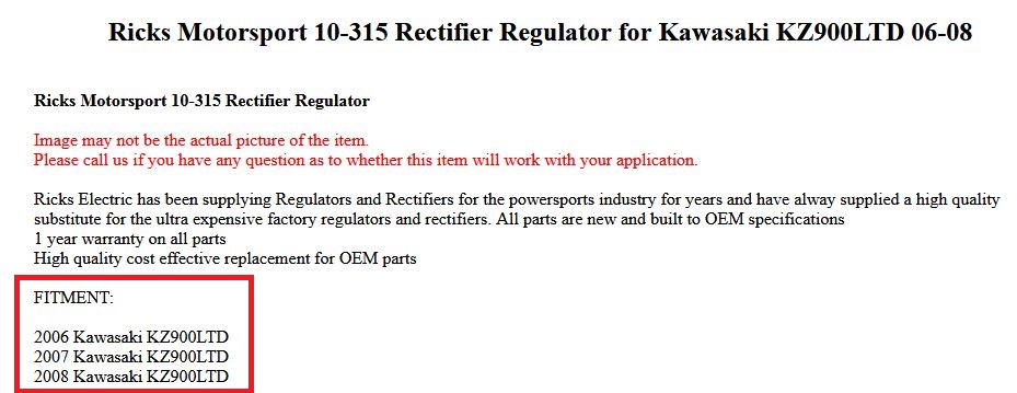

30 Sep 2018 19:41 - 01 Oct 2018 07:28
No eBay APP ID and/or Cert ID defined in Kunena configurationI don't even understand the Rick's Motorsport ad.
SEE It says:
I didn't know Kawasaki made KZ900LTD models form 2006 - 2008. :blink:
SEE It says:
Last edit: 01 Oct 2018 07:28 by 650ed.

Somebody goofed. I don't think that seller is Rick's Motorsport --- the item is, but not the seller. They've probably made a copy & paste error or something like that. buyer beware nonetheless, though
