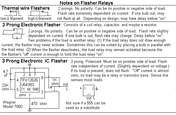

The ultimate is one that is run by a digital timer circuit. Then the load won't effect the timing at all. The Wagner model 7060 used to be the most common version of this type. The only problem is the fully electronic, aka digital, flasher requires adding a ground wire for it to function properly. Once you do that, it works with any type of load.
Here are some really old notes on flashers:
