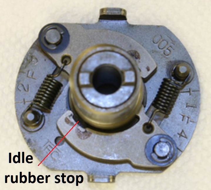

Also, the advancer arms have two little rubber stops on them. They often like to fall off. This will make the idle position too retarded by a few degrees (or if timed correctly at idle, it will be too advanced at higher RPM). Missing stops result in an increase of the total change in advance from idle to high speed. So you will want to make sure the rubber stops are in tact.

loudhvx wrote: Also, the advancer arms have two little rubber stops on them. They often like to fall off. This will make the idle position too retarded by a few degrees (or if timed correctly at idle, it will be too advanced at higher RPM). Missing stops result in an increase of the total change in advance from idle to high speed. So you will want to make sure the rubber stops are in tact.

thanks all. Patton, that's helpful. Will open it up and take a look soon.
