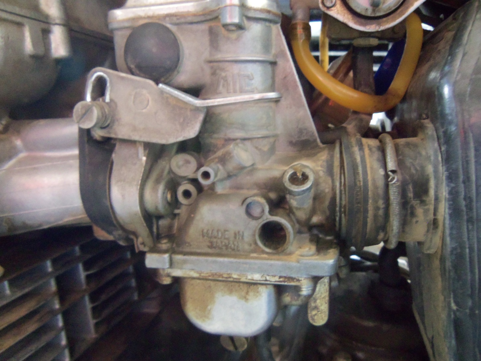

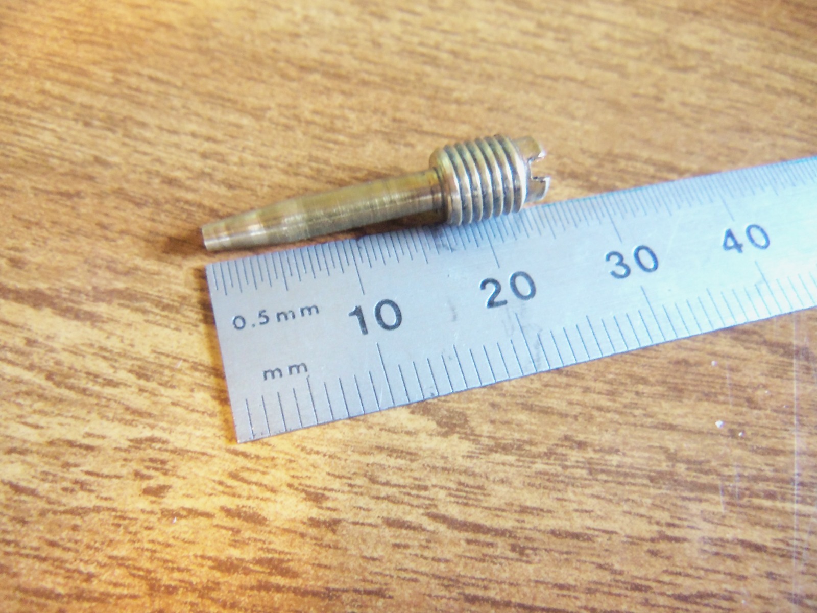

- kz650guy123
- Posts: 67
Re: Trying to figure out the air screw 79 KZ650BE ? Need an o-ring ?
08 Sep 2023 07:55 - 08 Sep 2023 07:58
Here is a picture of the carb and the air screw. Yes the carb is dirty.
As you can see there is no where to add an o-ring to this screw.
The teflon tape might work. I think I'll just use the grease for now.
Last edit: 08 Sep 2023 07:58 by kz650guy123.
