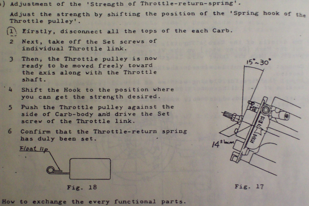

If you think that your carbs suddenly seemed to go to the rich side, there might be a simple reason for that when you have CR carbs. I have had CR's on three of my bikes. Anytime my bike started running different, and my plugs started showing rich in one or two holes. What I found out was that the o-ring around the seat would shrink in size, causing fuel to bypass the needle and seat raising the fuel level in that bowl. I always ran my bikes on either UniCal 76 105 race gas or VP 110 race gas. The stock Keihin o-rings would last about 3 months before they would shrink enough to cause the bike to run rich!!! If you read the Keihin CR manual,, they tell you to drain the fuel from the carbs every time you park the bike. Hell I never did that except on my race bike.
I used to buy those o-rings 20 or 30 at a time from Sudco. How old are the o-rings in your CR's??? Another thing with the CR's is how you set the float height. Before ypou check the float height, you first must angle the carbs 15 to 30 degrees. That takes the weight of the floats off the needle. I have had a real Keihin manual since the 80's. And thats one thing they stress about the floats!!! .

That's really interesting Dr. Gamma. I would have never thought of that. I'll definitely check those O-rings out when I'm setting the float height. So, 15-30 degrees set at 14mm. Much appreciated! Learning more and more about these CR's every day.

Got the carbs pulled yesterday and fully inspected them and swapped the 52's back in. The float height was spot on with the exception of 1 being a hair off (suspected I bumped it with my hand) because I swapped the 55's in with the carbs still installed on the bike and the space was very tight. Got the floats all in spec, checked the O-rings and they look brand new.
