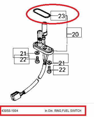

Have you installed a new O-Ring in the O-Ring groove of the gas level transmitter mounting plate?
Use some copper or aluminum washers under screws to prevent leaking there.

18 Mar 2017 14:20 - 18 Mar 2017 14:20Scirocco wrote: Have you installed a new O-Ring in the O-Ring groove of the gas level transmitter mounting plate?
Exactly. Make sure the groove for the o-ring is clean of any of your glue and use a new o-ring. See image below for part number. Ed

I posted a picture showing the rubber o-ring. I circled the o-ring and its part number in red. Please take a look at it and see if your bike has it in place. If you bike does not have that o-ring it WILL leak! Ed

18 Mar 2017 17:55650ed wrote:gordone wrote:
....When you say rubber grommet are taking about the rubber "gasket" around the plate?
Or are we talking about the cable cable access?.....
I have checked the o-ring and its 100%, it can be that it`s to tinn, so when I use the plastic it get thicker maybe...
