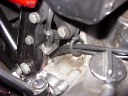

Example of overflow tubes routed to exit underneath the bike:

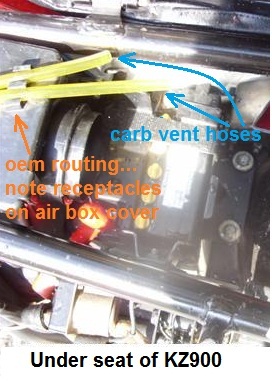

Example of vent hoses routed to exit to open air underneath the seat:
