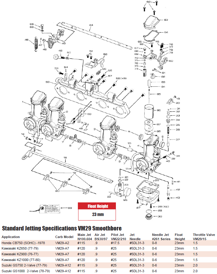

Re: Changing Stock CV Carbs for VM
02 Aug 2016 16:23
Kray-Z VM28's ARE NOT smooth bore carb's the only VM's that are is the VM29's and VM33's.

Back to carbs - I never looked at that feature before. In fact, I always had assumed all the round and flat slide carbs w/o butterfly valves were clean (smooth) thru the slide area (I've only recently seen RS, TM, and VM26 and VM29 Mikuni's on the bench, and never really paid much attention to the slide bores).
I assumed all the VM's were smooth straight thru, like the 29's, but the VM28's have the slot/bore for the slide going all the way thru, which creates turbulence...o.k.
Now that I'm aware of this, I see that the RS series flat slides are listed as a true smooth bores, while the TM33's flat-slides are only "smooth bore effect" performance carbs,...too bad, I planned to put the TM's on my GPz so the BS34's temporarily on it can go back onto the CSR they belong to. I'll still use the TM's, but I am disappointed they are not true smooth bores.
