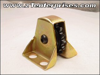

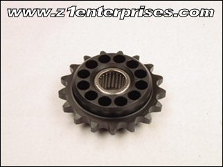

Hell, I think my worn chain tension sprockets, bearing shafts and roller guide parts are probably the noisiest thing in the whole engine, not a extra .001" or .002" shim gap...
which reminds me, I should probably replace that weird rubber tensioner wheel again.... seems like those really get roughed up.

Bruce, I can't recommend the Liska rollers enough. Not only are they cheaper, they last much longer.
