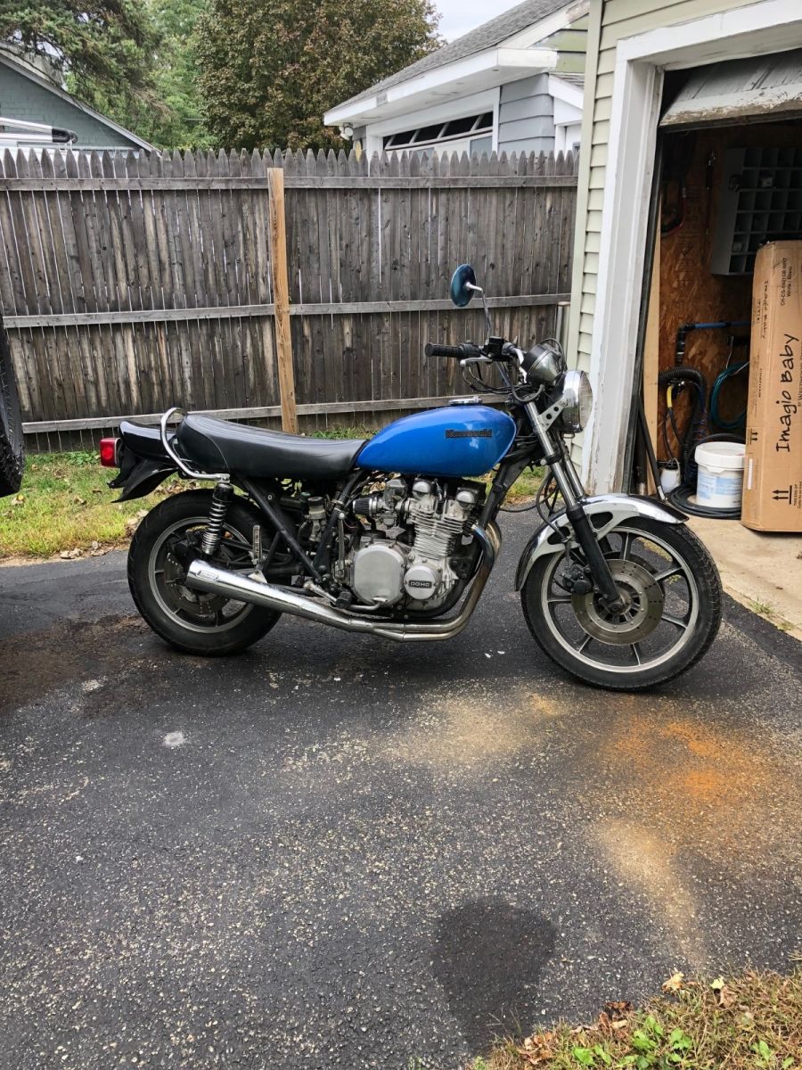

    thanks Hardrockminer, I did not know that.  My bike according to the guy I bought it from was a theft recovery in the 90's. It has mostly kz1000 parts on it and is very bastardized. I have never had a z1 before so most of what I know is from reading online, mostly from this website.  anyways my vin is in the 52 thousands so I guess it likely had the chrome pegs. I'm not looking to make it factory correct perfect matching date codes etc., just want to get it close and ride it. I would gladly buy either style in good condition if anyone has some they don't need.

    It's a nice looking bike but visibly very little of it is from a Z1, including the entire front end, shocks, carbs, wheels, rear brake, right control switch, air intake, valve cover, etc etc.  You may want to just enjoy riding it as it is, particularly if it's reliable as it is.  There is a great book on Z1's by John Brookes...I recommend it if you want to learn about them.

    Thank you for saving it from whomever did that to it.

    Just curious....does your engine S/N start with Z1E???

    valve cover looks z1 to me

    I don't have any spare Z1 parts to sell.  I was just curious if your engine was a Z1.

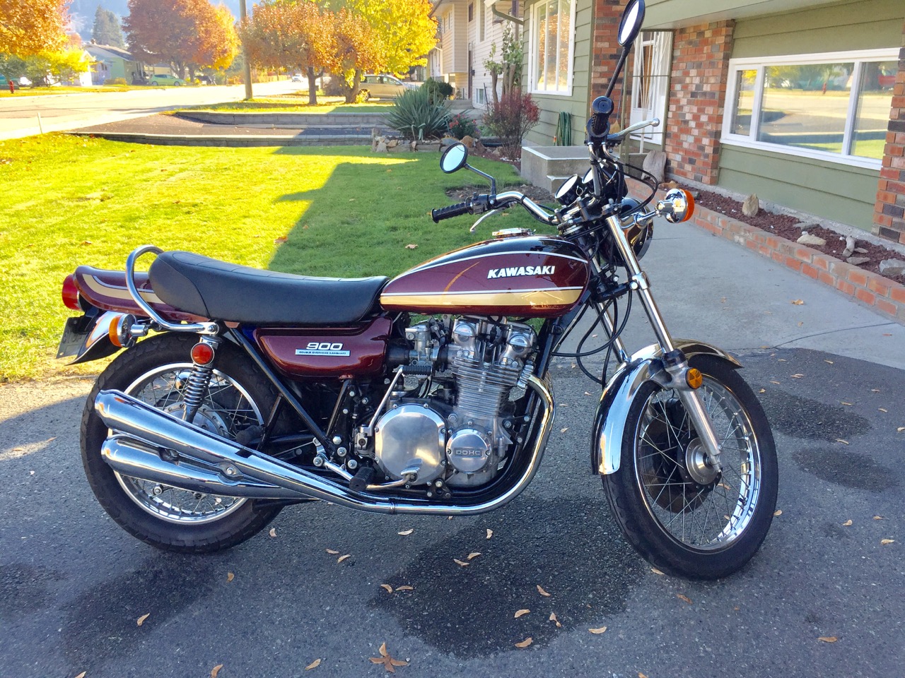

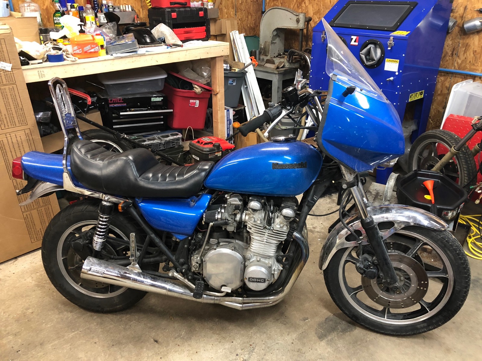

    This blue one is a Z1 valve cover from engine S/N 554xx.  (Close to this frame S/N)  Note there are no semi circles on the end.
The candy apple red one is from S/N 72000 (approx). Again, no semi circle on the cover. I think they started that in '77.
Because of the rather large amount of non-Z1 parts on the bike I thought perhaps the engine isn't Z1...hence my question.
