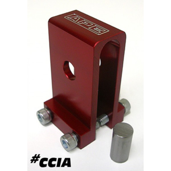

BTW: my CAM CHAIN IDLER ADAPTER
Worked like a charm on my ported Z1000J head on Z1B 900 engine.
Time sert need more metal removal.
