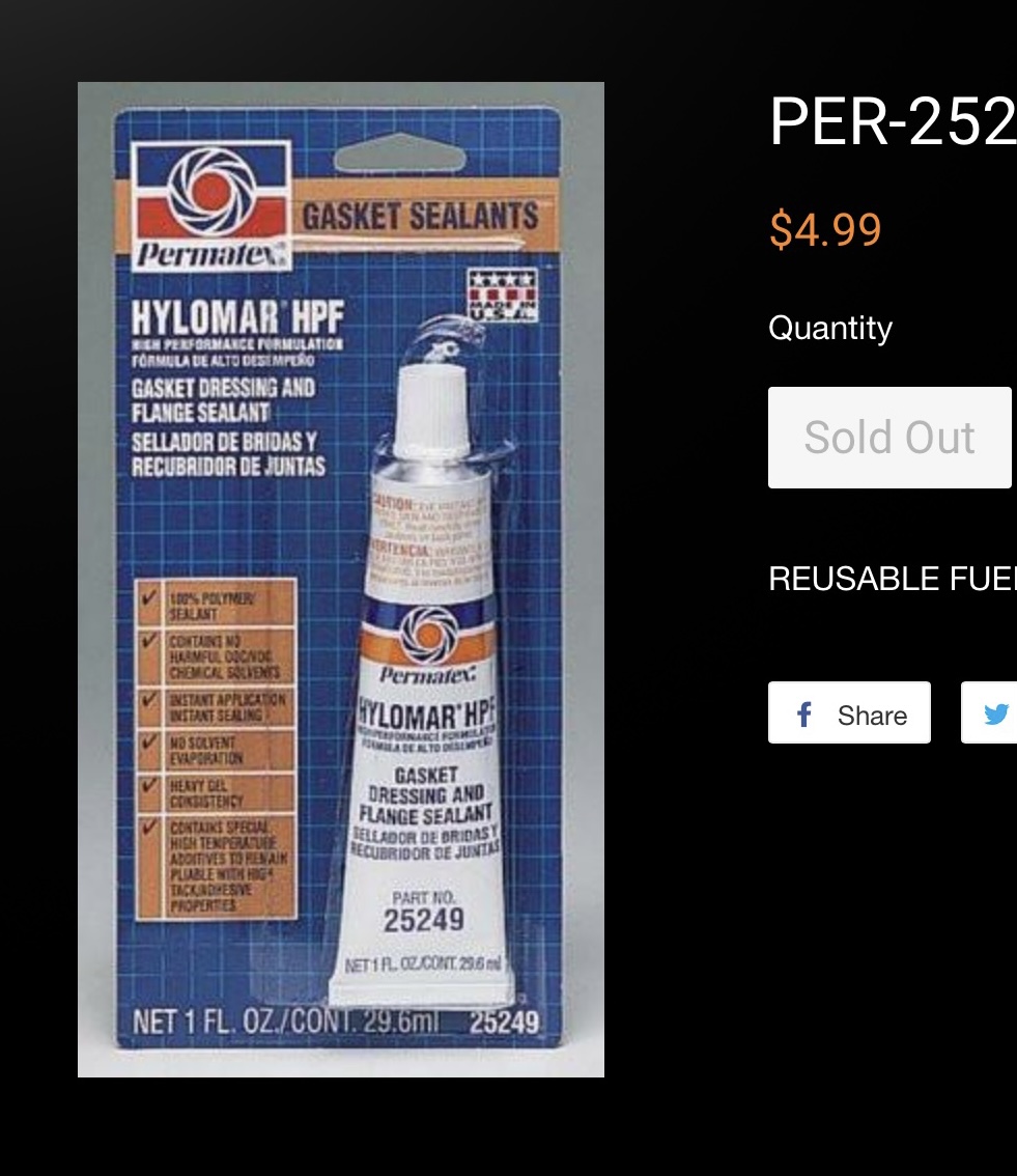

+1 on the Hylomar. I’ve never had anything leak with the stuff.
I have a twenty year old tube that’s nearly all squeezed out and the Hylomar HPF still left is as good as the day I bought it. The new Hylomar hazes over and the tube goes hard in a couple of years however.
Heres the good stuff but it can’t be found anywhere. You can buy Hylomar but not Hylomar HPF.
