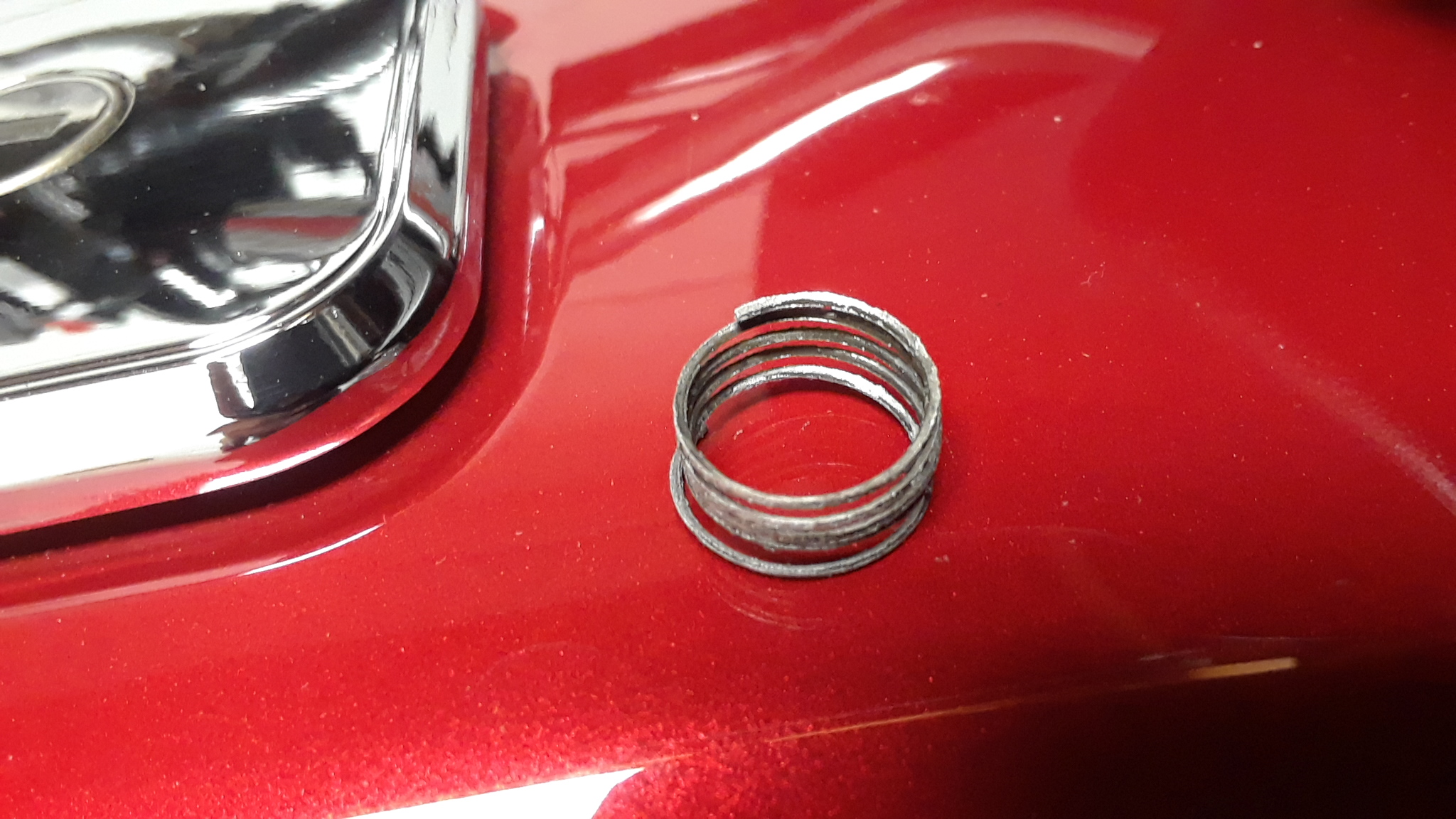

#3 spark plug hole is the culprit, and two others seem likey to become problems too. May as well do them all while I'm at it
Which insert material is the best choice to use for a trouble free and permanent fix?

Re: Spark Plug Hole Thread Repair
28 May 2022 18:08
1982 KZ1100-A2 bike
1984 ZN/ZX1100 motor
