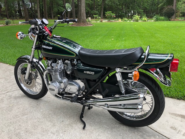

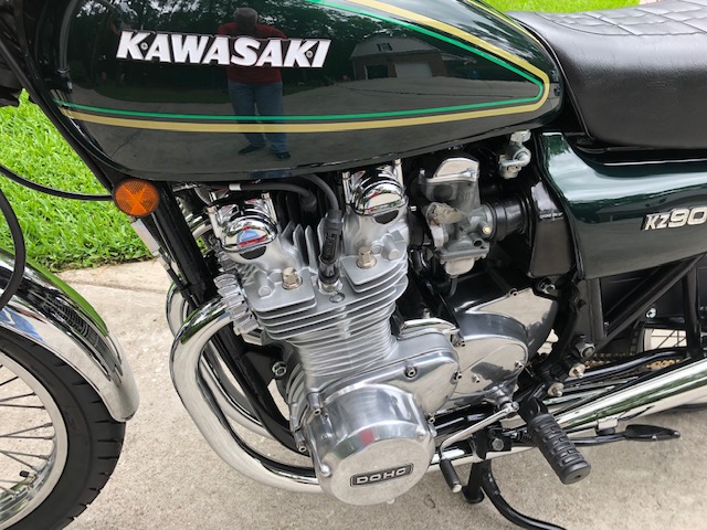

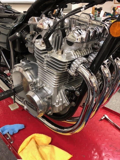

Good news, between mixture screw adjustments and the hotter B7ES, I finally think I'm really close. Plugs are now not fouling and have a tan color,,,,,,,,, and of course the bike is running really nicely . Finally get to enjoy the fruits of my labor on this restoration. Rode it to Cars and Coffee this morning and it got plenty of attention.
Thanks for everyone's input and suggestions appreciate the help.

That bike is way too nice to run badly!

Beautiful bike!!! Ed
