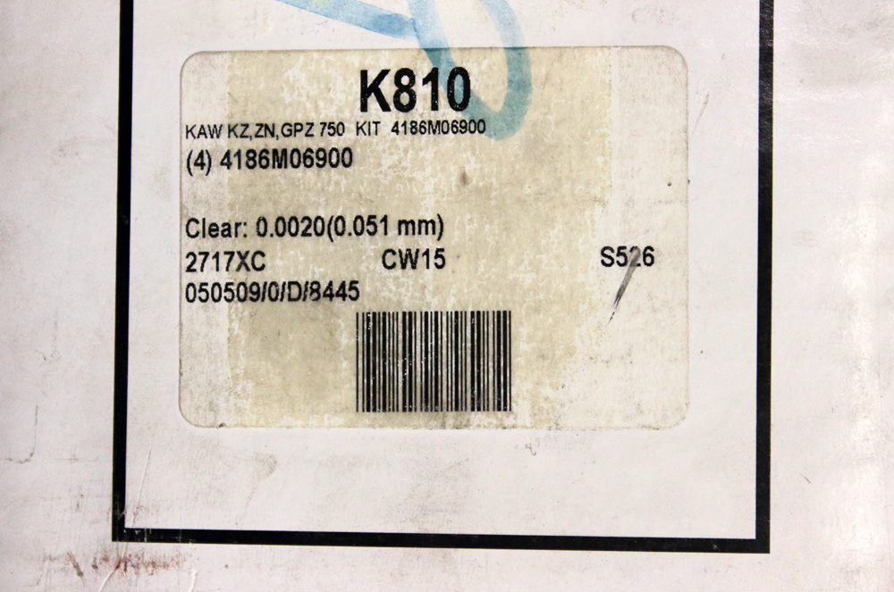

Bore clearance is 0.051mm = 2 thou for the Wiseco pistons.
Last edit: 06 May 2020 10:38 by zed1015.

My Zephyr 750 ran more than 70000km on Wiseco K810 kit without any issues. Cylinder-to-piston clearance was set to that recommend by Wiseco: 0.051mm (0.0020) .
