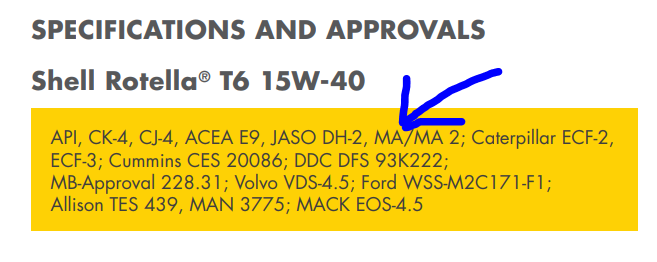

Rotella T6 15w40 is JASO MA certificated

As for the Rotella T6, I took pictures of the front and back of the jug, and it's got a "blank bottom" donut cert on it - top says "API Service CK-4", with "SAE 15W-40" in the middle, and nothing on the bottom half. As others have said, it lists JASO MA/MA2 in its certifications.
