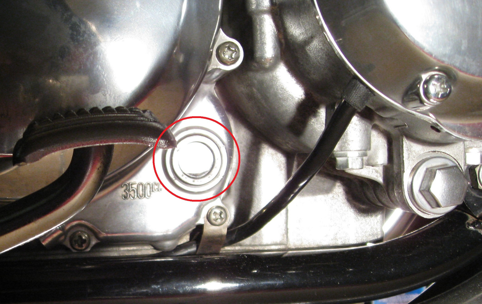

If you haven't already done so, take a look at the lower half of the right side of the engine to see if there's an oil level glass window there. With the bike on the centerstand the oil level (with the engine shut off) should be near the top mark next to the window. If it's above that you may just have too much oil in the crankcase. Picture below (sorry about the glare). Ed
