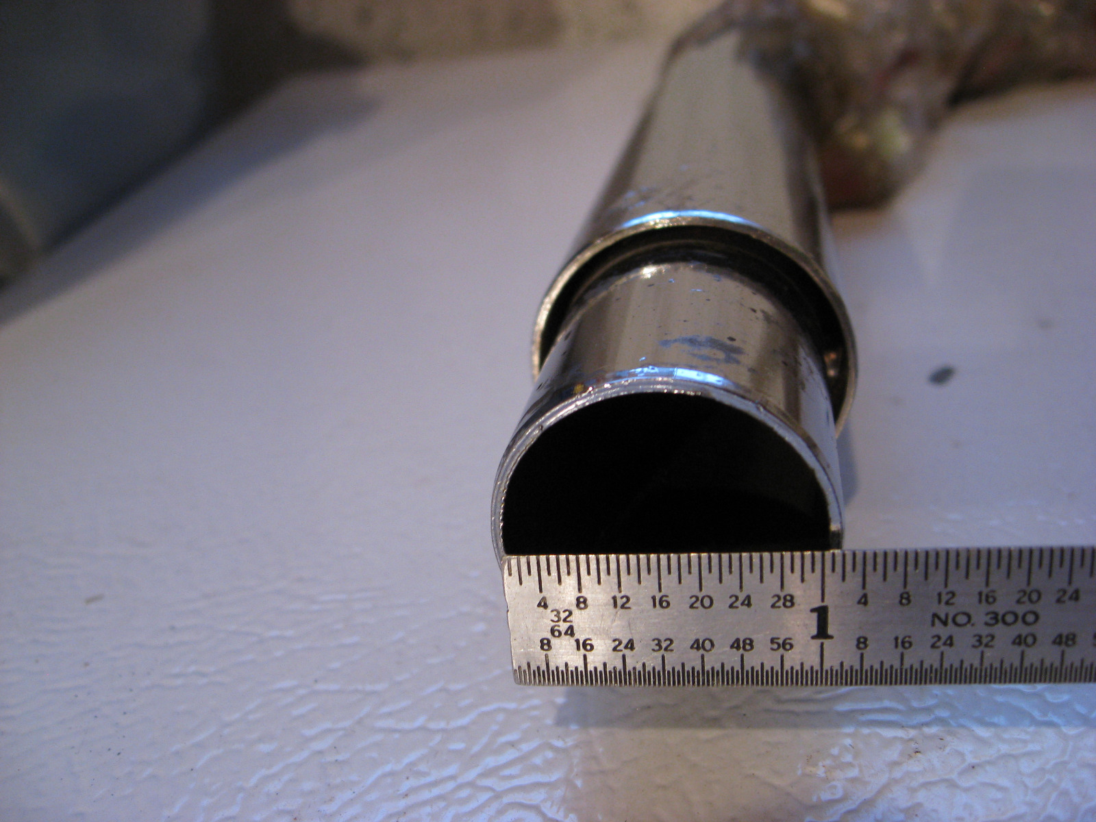

Re: 1980 KZ440 LTD Mac 2 into 2 Advice
18 Apr 2020 07:02
The original factory exhaust system on my 1977 KZ650 is still in great condition, and I suspect one reason is the fact that it is double walled. That is to say there is a second set of pipes inside the outer pipes that one sees when looking at the exhaust. This prevents the pipes one sees from turning blue unless there is significant over heating. I could be wrong, but I would expect the original pipes on the KZ400 to be made in the same fashion. Consequently, they should last pretty much forever although there is a weight penalty for such a robust exhaust system. The image below shows one end of one of the stock header pipes. I don't know of any aftermarket exhaust system made with double walled pipes. Ed
