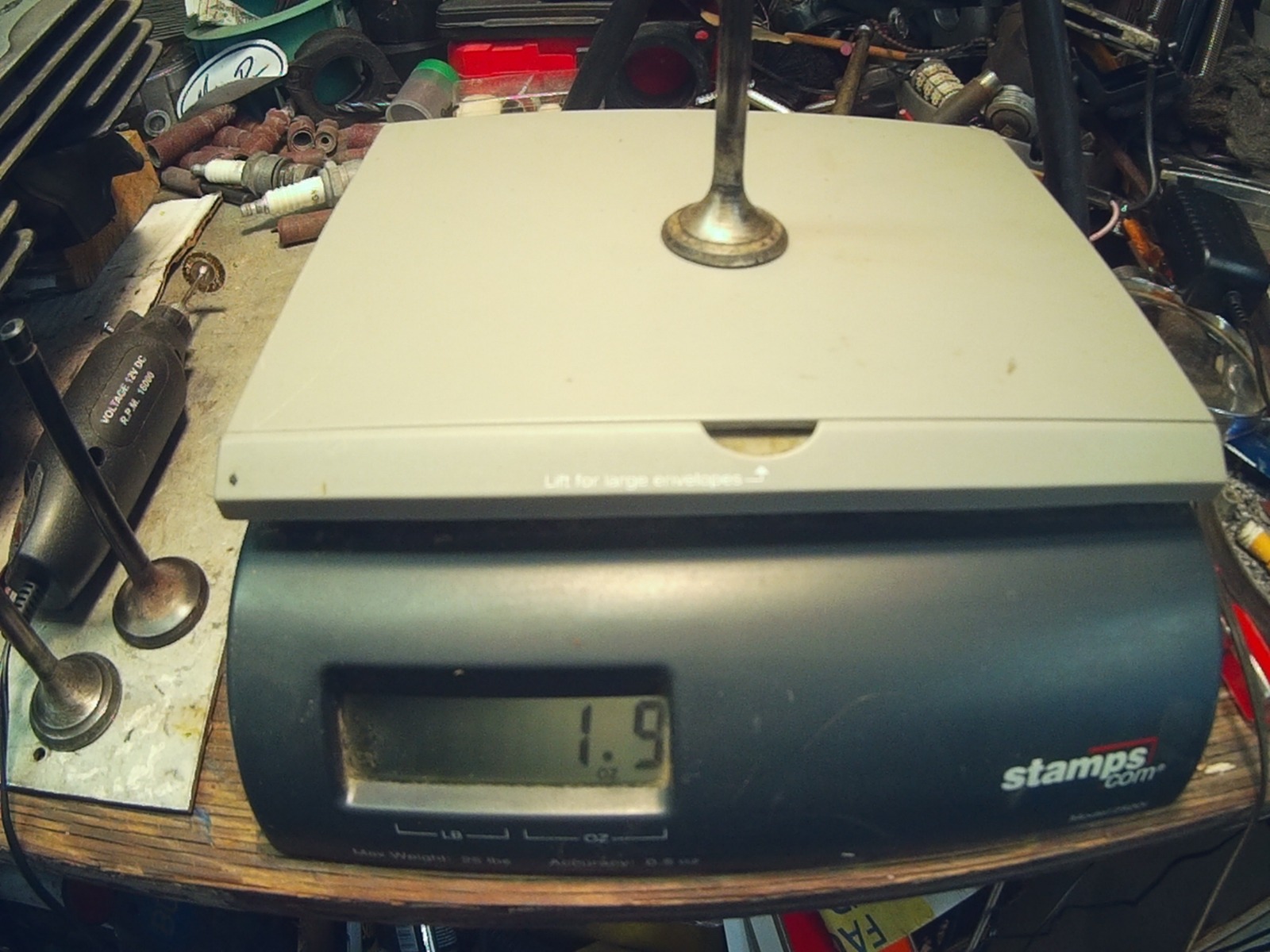

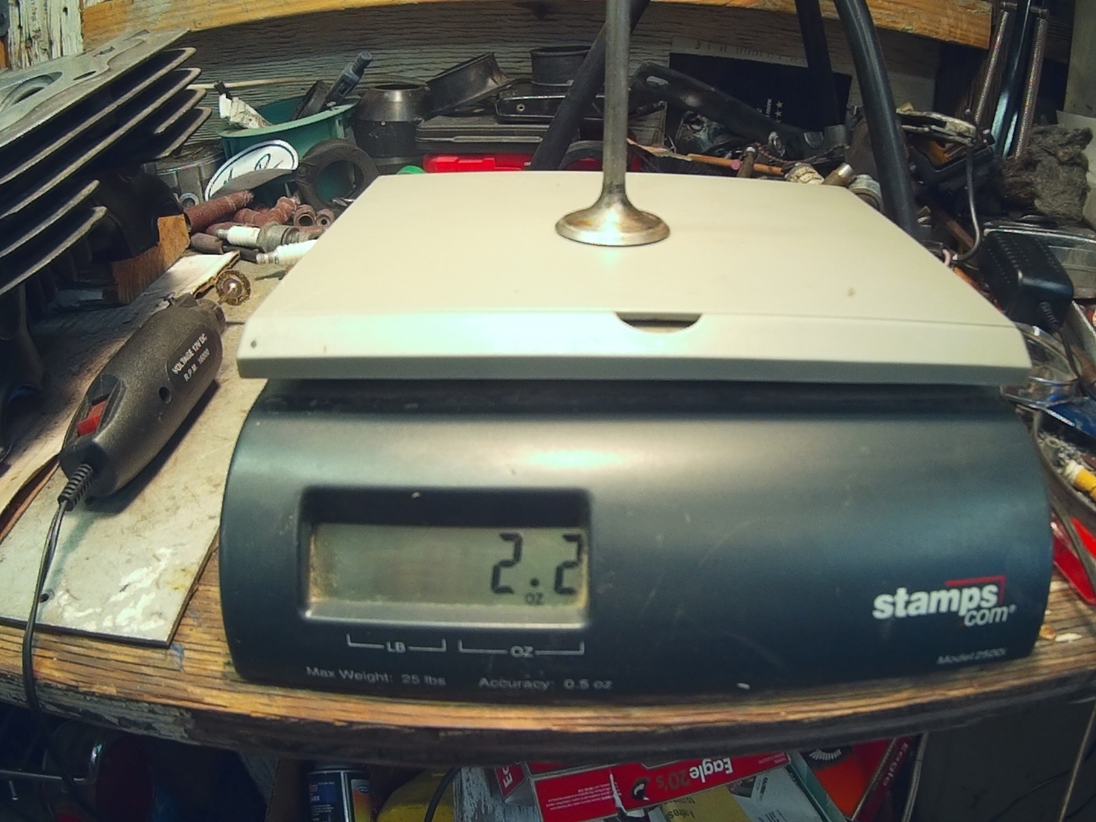

They didn't seem to hold up as well as OEM. I'll know more when I take the intakes out this time. They appeared to be lighter but I weighed them and they're not by much.
OEM
Doremi
OEM intake
OEM
Doremi
OEM intake

Steve, I am surprised that the Doremi valves are that much lighter...and I wonder why. If they are the same length and diameter (hence same volume of metal) then they must be made of an alloy to make them lighter. Then comes the question...is a lighter valve better or worse?? I'm thinking better but I really don't know.

They seem to be the same but didn't hold up like OEM.
