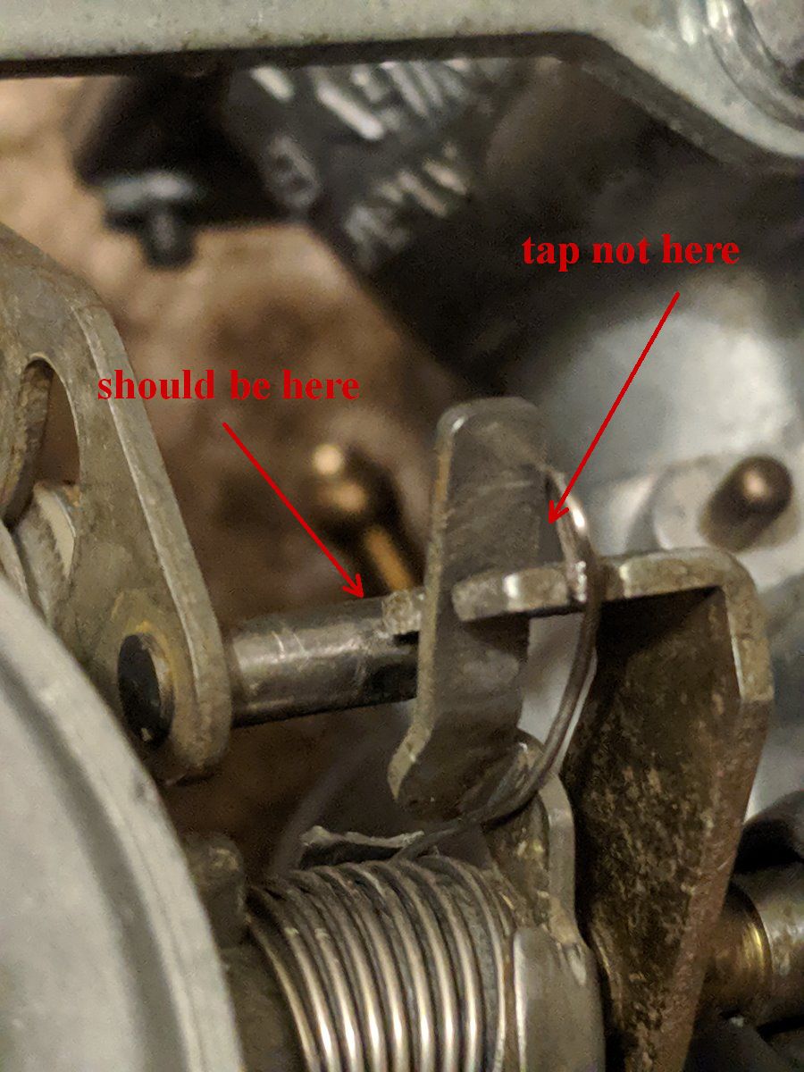

EDIT: FIXED. Wrong placement, and spring was loose by a turn so it didn't have enough force to close. Time to test on bike!
Great! I would really love to try it out, BUT
Now I have another problem...
I was putting the carbs back together, and am having issues with the choke spring. There was a topic posted about this, but the OG didn't respond with a picture of how it was set up.
The choke valves are uneven, and when moving the lever to the position where they are open, the spring does not push the other valve back.
I've tried different variations, but since it's obviously not working I guess I have it wrong?
