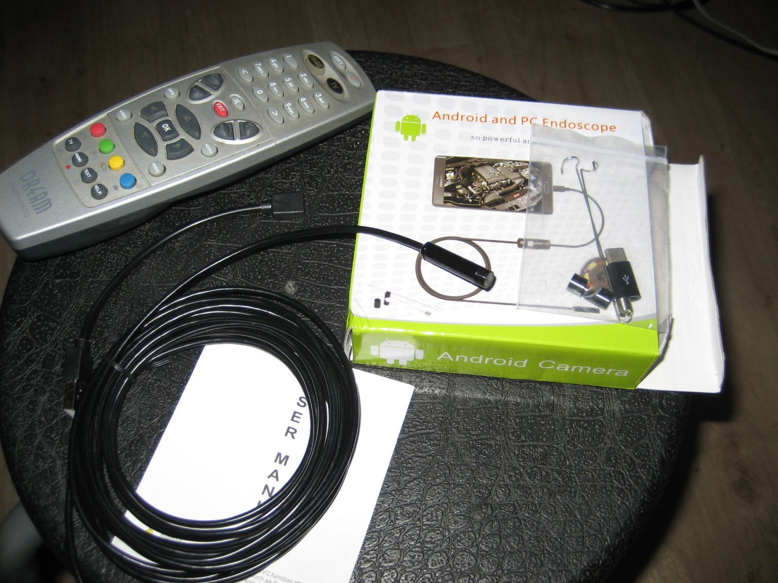

No eBay APP ID and/or Cert ID defined in Kunena configurationI just ordered a bore scope to check the cylinders. If one or more are scored that would be a game changer I'd like to be prepared for this next time around.

Steve is right, it´s cheap Investment. My scope comes with an periscopic mirror to view upside down to the valves.

Plus those things have worked well for sewer pipe inspection.
