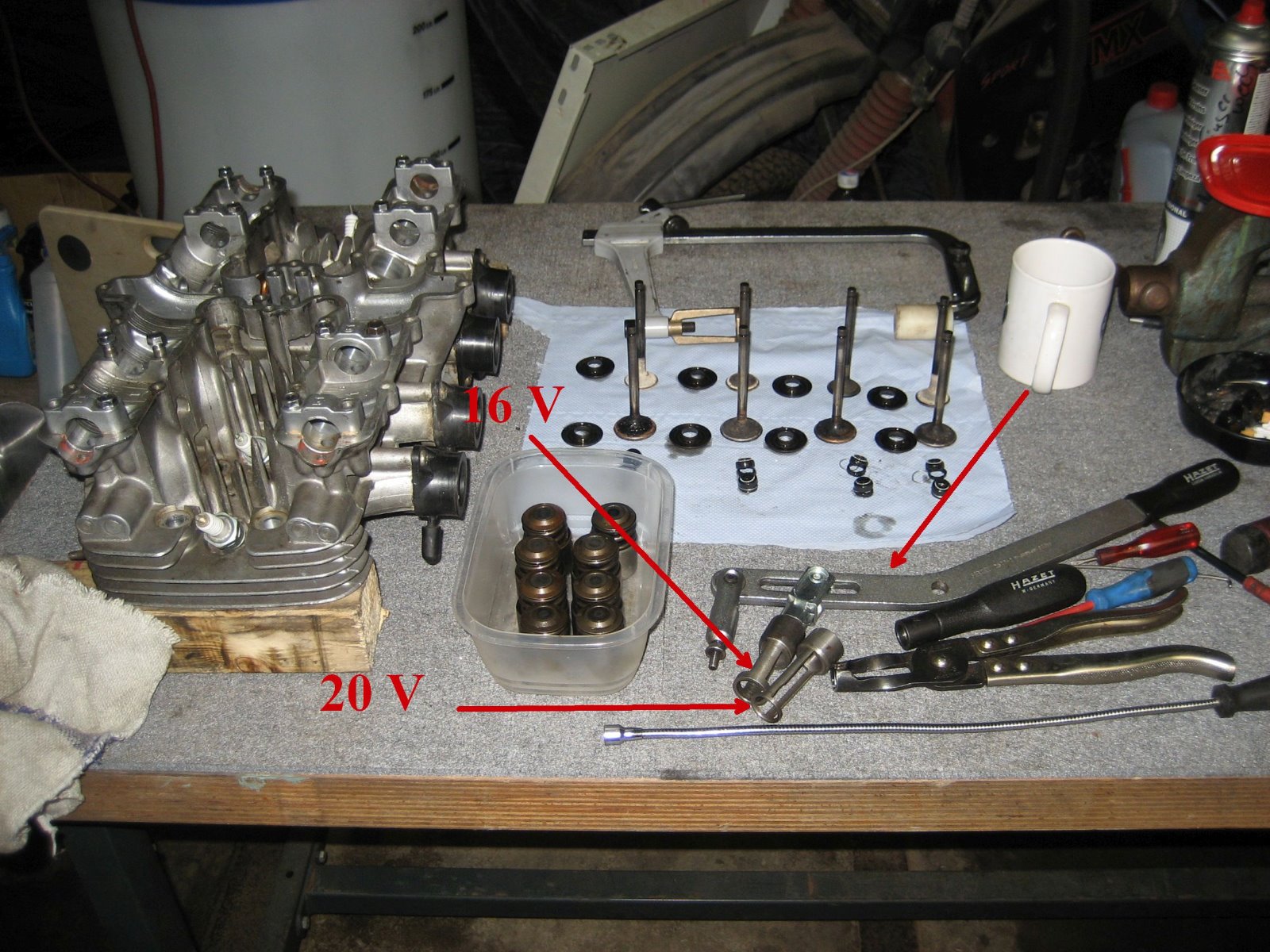

I've heard some use the HAZET 2577-2 VALVE SPRING COMPRESSOR

Take a look at your engine. I believe you will find that the shims are UNDER the buckets. Given that, there is no way to replace a shim without first removing the bucket and there is no way to remove the bucket without first removing the cam. Ed

The Picture i post before you see a KZ 650 head with shim under bucket. You have to remove the cams and buckets for a valve shim change.

Thanks guys for the valve tool information. I think it might be more trouble than it's worth to buy and adapt a tool to use in that way, so I'll just remove the cams instead.
That's where you're wrong.
Apart from the tool I posted, which works on bigger buckets and bigger shims on bigger engines, a dexterous person (not me) could do it on this engine using a lever and a metal sliver to push and hold down the edge of the bucket. Alternatively, some people do it by stuffing something like a folded ziptie down the spark plug hole to trap the returning valve (in between the back of the valve face and the cylinder head). Either method would result in holding the bucket down sufficiently to pop the shim out with the edge of a small flathead screwdriver.
650ed wrote: Take a look at your engine. I believe you will find that the shims are UNDER the buckets. Given that, there is no way to replace a shim without first removing the bucket

On a shim under bucket style engine the cams HAVE TO REMOVED to get at the shims period unless you beam the shims out. And if you ever manage to remove the the shims leaving the cams in place please record the procedure and post it.

25 Jun 2019 19:12baldy110 wrote: On a shim under bucket style engine the cams HAVE TO REMOVED to get at the shims period unless you beam the shims out. And if you ever manage to remove the the shims leaving the cams in place please record the procedure and post it.
That's a pretty stupid position to hold for ALL shim-under-bucket-style engines. What do you think that device I posted is for?
