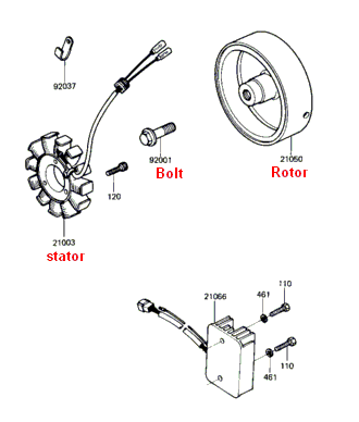

Can someone send a picture of the specific part (rotor) I'm supposed to be looking at? It's under the stator cover, or where my chain is located? What's the specific rotor called/where can I find new parts of I need 'em?

Hey at least that 750 twin is super light... (sorry
So if you look at the left side of the engine, below the cylinder block, there is a big round protrusion that says "Kawasaki". If you remove that cover you will find the starter and starter clutch, but the main thing you see is the alternator. The alternator consists of the stator which is a big spoke-wheel looking thing which stays attached to the cover (which you said you already replaced to convert to 3-phase). Then there is the flywheel which is a big cup-shaped thing bolted directly to the crankshaft. We call it the rotor because it is the magnetic rotor for the alternator (in addition to being the flywheel). On your bike, the starter clutch attaches to the back of the rotor, I think.
Anyway, the hex bolt at the center of the rotor can come loose and possibly interfere with the cover, which will then lock up the entire motor, kickstart and all. Note: there is a chance the bolt is left-hand thread.
If you haven't recently messed with that bolt then it seems less likely that is the problem, unless the bike is new to you.
Once you get it home, one thing you can do is remove the plugs to eliminate compression, put the bike on the center stand, and try to rotate the rear wheel backward in gear. Don't use a lot of force, just arm strength but don't use chain-slack and momentum to bang it. If it is the crank, you should still be able to get the bike in first or neutral by wiggling the rear wheel while operating the shift lever.
If it suddenly moves freely in reverse, don't go forward. put it in neutral and look under that cover.
