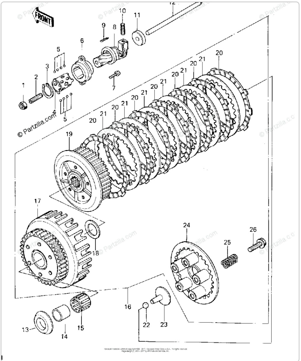

Nessism is referring to the clutch release mechanism that the cable attaches to under the case cover. It is the assembly at the top of the diagram in the link below

Throw out bearing is #22 and plunger is #23
