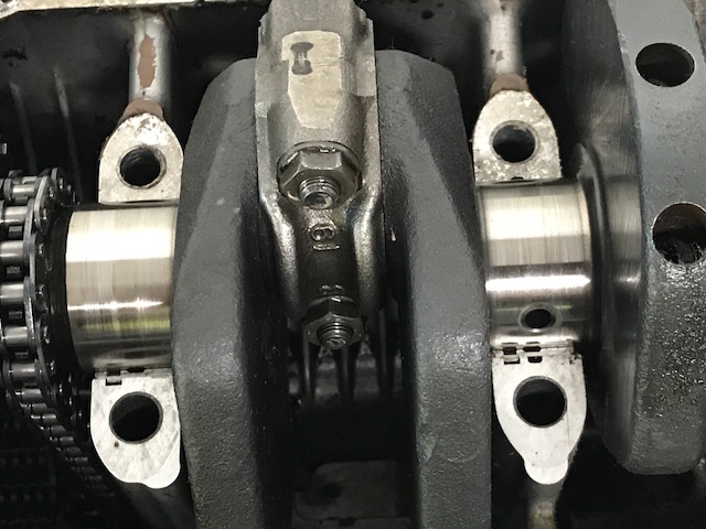

Here are some pics of the some main bearing halves. Now I have not checked them with Plastigauge so my thoughts on replacing them are only based on look and feel. Mostly I thought it might be a good idea to install new bearings since I'm into it this far. Thanks for the help and advice.
There are raised bumps on several of the upper halves. I haven't yet removed the crank to check the lower halves. It's difficult to capture on camera but the dark round raised spots can be felt with the finger.
The crank journals look pretty good though.
Last edit: 22 Sep 2018 14:47 by MkC.

After seeing them forget the plasticgage idea (you know about that anyway) and see what others think....... look a little rough to me.

That is really interesting. I cannot imagine how the bearings would get bumps. I think you will want to plastigauge them anyway. As I recall, the color coding has to do with the thickness of the bearings. Are the crank journals ok?

23 Sep 2018 02:36Sizes in both main and big end shells will most likely vary , it's rare (but possible) for them to be the same.MkC wrote: So if I understand this I'll need to remove the rod bearings and look for a color marking? Also, based on that link is it safe to say there is only one main bearing size (color) or do I need to be mindful of variations there as well?
Simply go by the colour markings on the edge of the shells for re-ordering replacements and if the paint is no longer visible then use the number system on the upper case and crankshaft..
The raised dimples are common and i have seen it plenty on the camshafts shells of the bigger Z900/1000.
I think it's either heat/lack of lubrication or batch related and tend avoid re-using them.
Looking at your pics there is also evidence of light scoring and i would fit new shells and be sure to use a quality oil when re-built.
