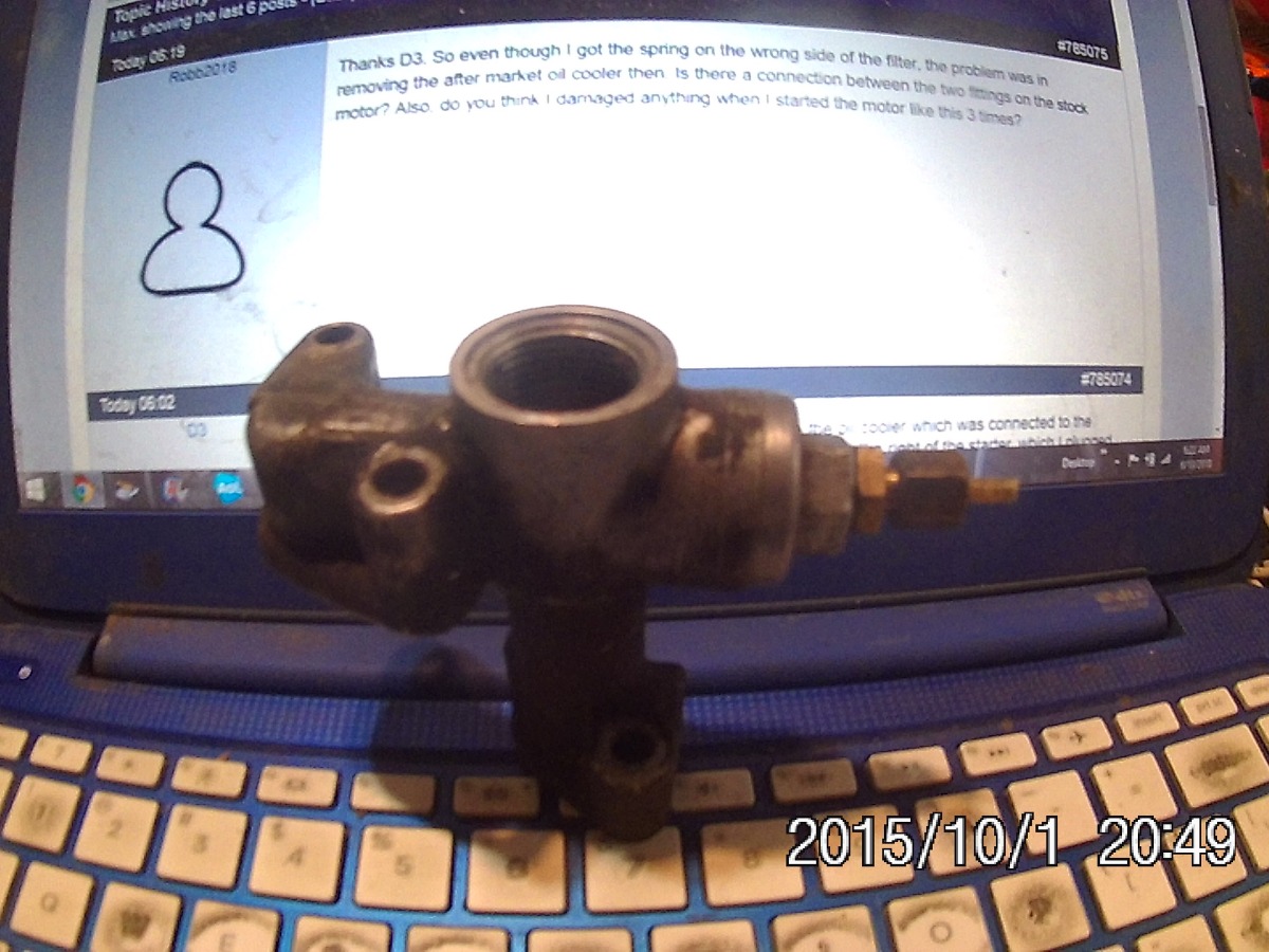

I removed the cooler because I wanted to make the bike as close to stock as I could. Dodgy work by PO would be no great surprise. So I can replace that fitting if I can find one or just run a pipe between the two plugged holes? Here's what I have:
KZ900; Z1

#785080
I see what PO did now. Well this all finally makes sense. Ebay has a stock connector pipe for 40 bucks. I'll just order that. Dammit, was really looking to doing a test drive this week. Thanks so much for clearing this up guys.
